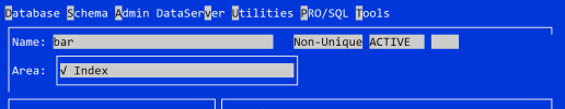

Here is an example, from the character-mode Data Dictionary, of adding a table and an index to application storage areas (note the "Area:" textboxes):
Note: your UI will look different because this I did this in release 12.8.
Note the AREA "<area name>" qualifiers on the ADD TABLE and ADD INDEX statements in the dump of the schema:
Knowing this syntax allows you to make wholesale changes to the assignment of your schema objects to areas by editing the schema defintion file (testdb.df) prior to loading your schema and data, without having to fiddle with the Data Dictionary UI for each object.
