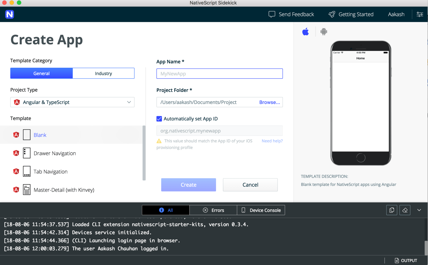

To create a new project use “tns create MyApp –ng”. It will create a new app named MyApp with an Angular & TypeScript template. Alternatively, you can use NativeScript Sidekick to ease the process.
Here is a picture of NativeScript Sidekick:
Once this app is created then you can use any editors you want to use. I am using Visual Studio Code because it is lightweight, fast and easy to use.

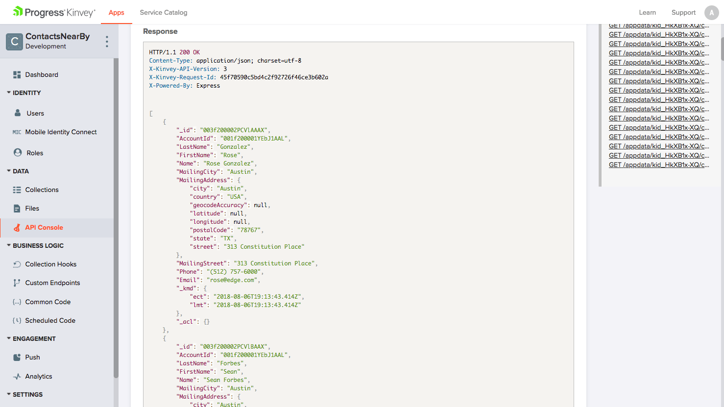

And this is the screenshot of the response for my collection:

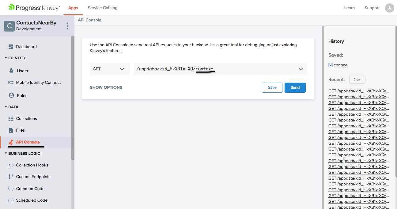

You can get this by sending an API request within your Kinvey API Console. Below, context stands for the collection name.

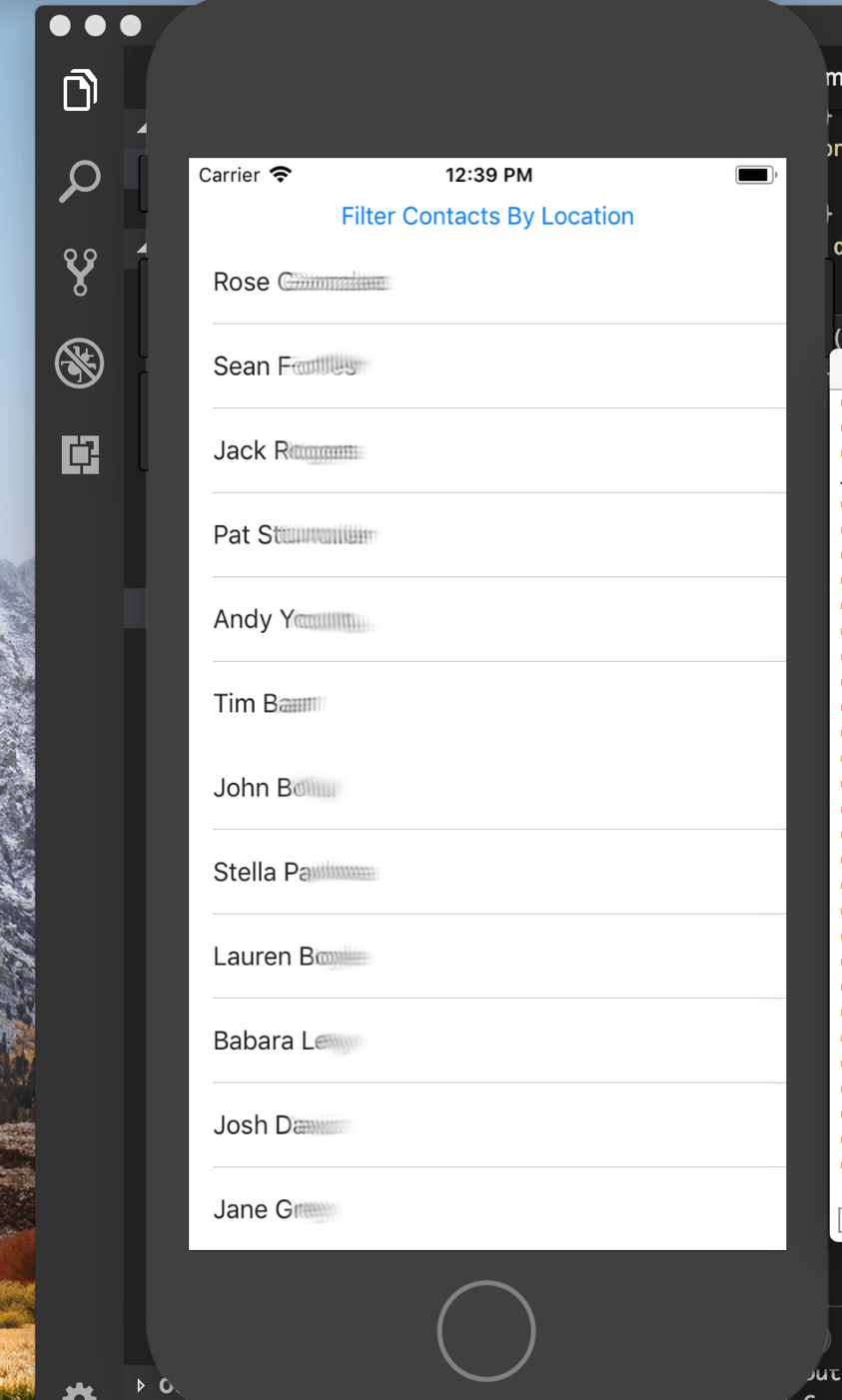

You should now be able to see your all contacts in the front page of your app. I have created another module to show filtered contacts. After clicking on the homepage’s button it will redirect to the second page where I am using a card view to show a contact’s name, phone and email address.

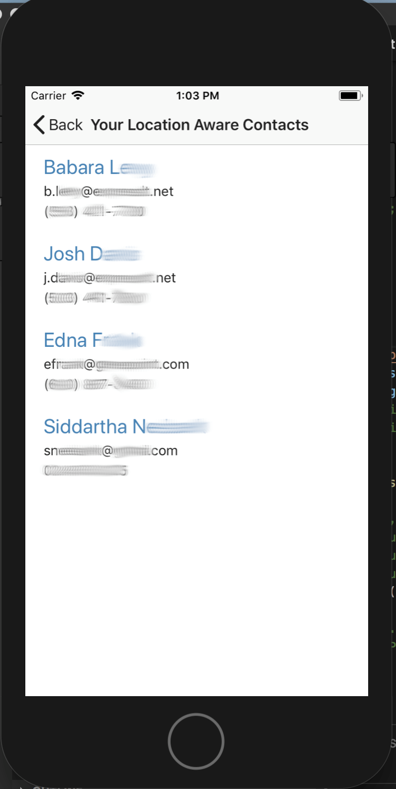

Now that you have your current location’s coordinates and each contact’s coordinates you should be able to find distance between current user and his/her contacts. The next step is to filter them by distance.
To get the distance, you can apply this sample code:
calculateDistance(lat1:number,lat2:number,long1:number,long2:number){
let p = 0.017453292519943295; // Math.PI / 180
let c = Math.cos;
let a = 0.5 - c((lat1-lat2) * p) / 2 + c(lat2 * p) *c((lat1) * p) * (1 - c(((long1- long2) * p))) / 2;
let dis = (12742 * Math.asin(Math.sqrt(a))); // 2 * R; R = 6371 km
return dis;
And with that, you can easily develop an app with the NativeScript-Kinvey integration. Below are screenshots for both of the pages we’ve just created.
