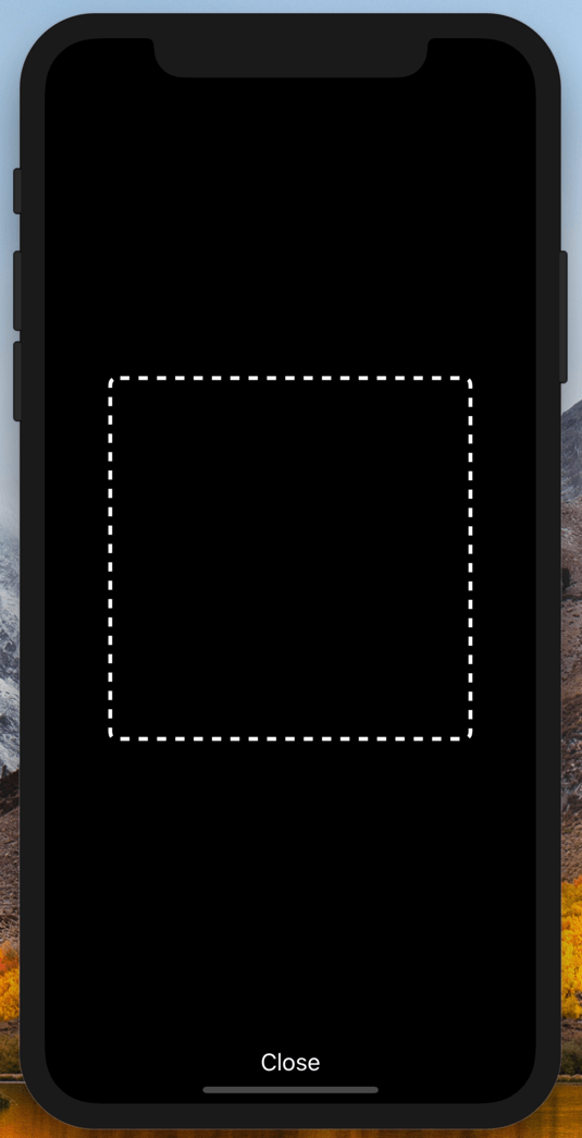

Include the following code in your HTML file for Barcode Scanner. It will open a new camera window.
You should now be all set with Barcode Scanner. Here are screenshots of what it should look like on both iOS and Android:

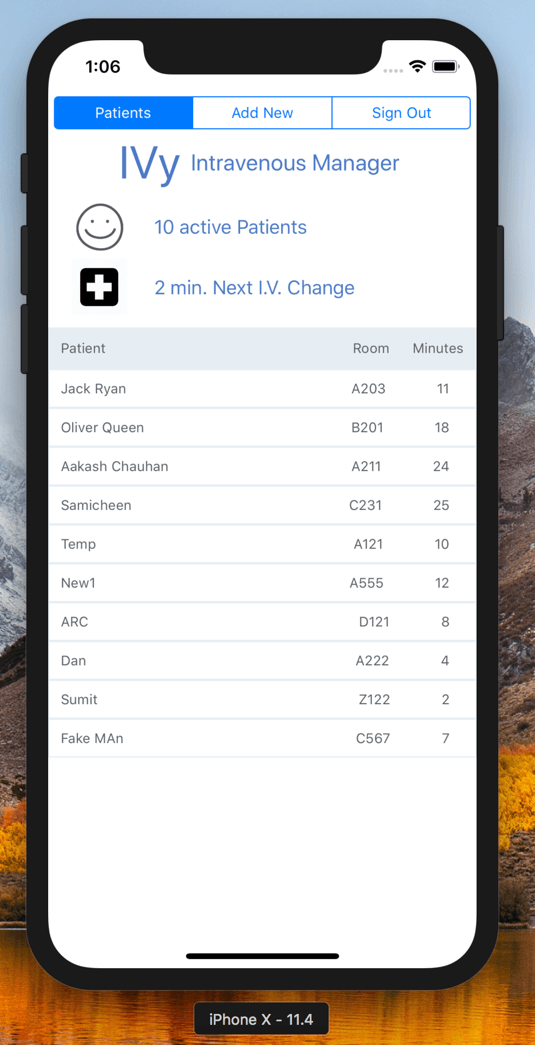

When you navigate to the segmented page “Patients,” IVy displays a list of the patients as below:

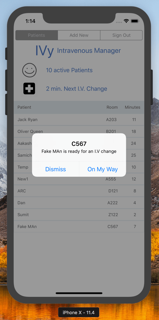

For this list in the app, you must first register for the Live Service. You can subscribe to messages from the collection. In this app, we want to use a snippet (as per my GitHub code) where we can show a dialog box when the patient’s remaining IV time ends.
This is the dialog box the user sees when a patient is ready for an IV change:

Here we have a table of the patient name and details. To build that we can use “RadListView” as below:
