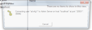

when i am starting localhost server under progress explorer it's prompting following error.
connecting user "ail.mfg1" to Admin Server on host "localhost" at port 20931".(9096)
