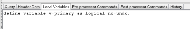

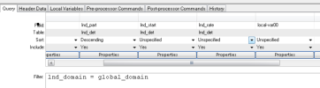

Hello Marco, I don't have a 3.6.11 and icbr007 opens 3.6.1 which didn't have any example of the code although it did use variables, but I didn't see that they had been defined anywhere in the browse.
I was able to create the local-var00 and add to the browse fields. See below.
Hopefully, I pasted the code in the correct spot, as below.
Then, on the local_variables tab I added the variable, hopefully correctly.
So, when saving, I'm sure know what's coming...
I get this lovely message:
I appreciate any additional guidance you willing to provide.
You need to convert the code to a Function.
On Browse Maintenance 36.4.8.13 open ic007. Or search for other examples; there are a lot of browses with defined Functions.
