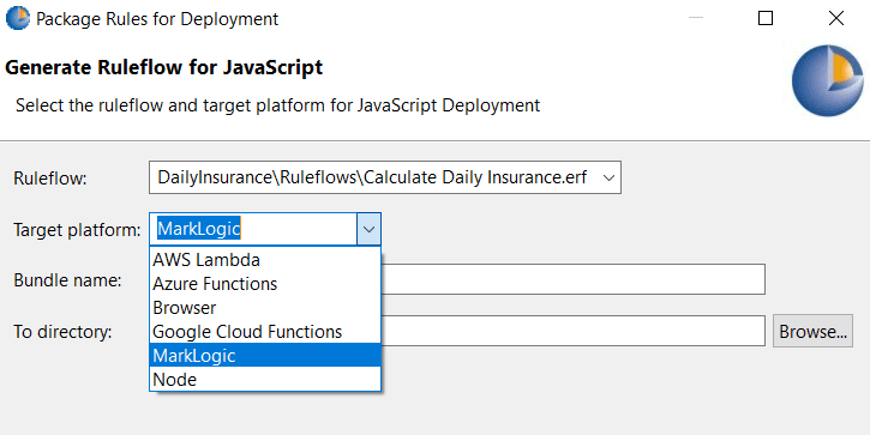

In Corticon Studio, we can generate decision services with just two clicks by using the MarkLogic target platform as shown below:

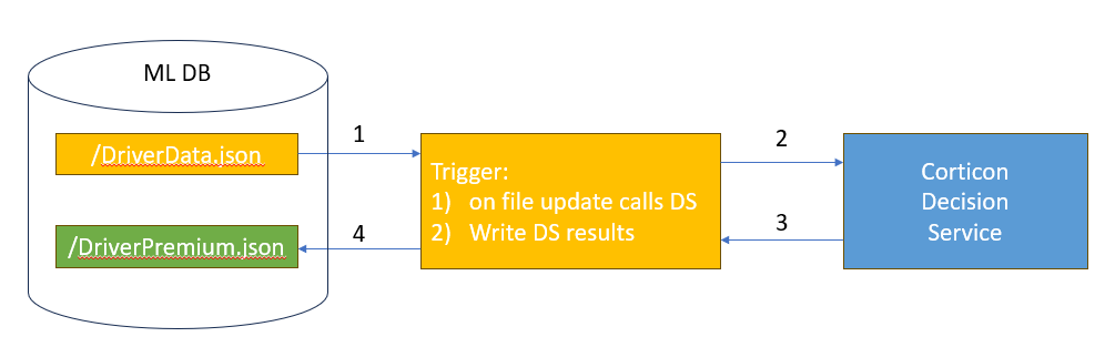

From an implementation point of view, the main actions executed by the trigger can be summarized as:
All the data that the business rules need is passed in as part of the decision service input payload.
This is illustrated in the following diagram:
The yellow box in the middle of the diagram shows the trigger code which is under the integrator’s control. The blue box to the right shows the decision service, which is under the control of the modeler.
This is the simplest way to use a Corticon decision service. In step 1 in the diagram above, the trigger executes when the file is updated and calls the decision service (step 2). In step 3, upon completion, the decision service returns the results which are inserted into the MarkLogic database in step 4.
This design pattern is the easiest to understand as the MarkLogic document is the complete input to the decision service.

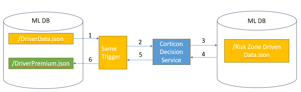

Business processes are complex, and for many decision services, it is not desirable or practically feasible to pass all the data required for all conditions as part of the input payload. This would result in a very inefficient process as the input data would be too large and could take too long to gather.
In this second pattern, we let the rules drive what additional data they require to proceed with the decisioning process.
This pattern is similar to the first one. The main difference is that the decision service, in this example, retrieves the risk of the zone driven for this specific driver by reading an additional document in MarkLogic database.
We commonly see this pattern applied in complex business processes that contain conditional flows requiring specific data sets.

Trigger Implementation
- Reading the document as JSON from the collection:
const data = cts.doc(uri).toObject();
- Executing the Corticon decision service:
const result = decisionService.execute(data, configuration);
- Writing the business-rules results in MarkLogic database
xdmp.documentInsert("/insurancePricing/result.json", result, insertConfig });
First Design Pattern – All Data In

Second Pattern – On-Demand Data Retrieval in Rules
