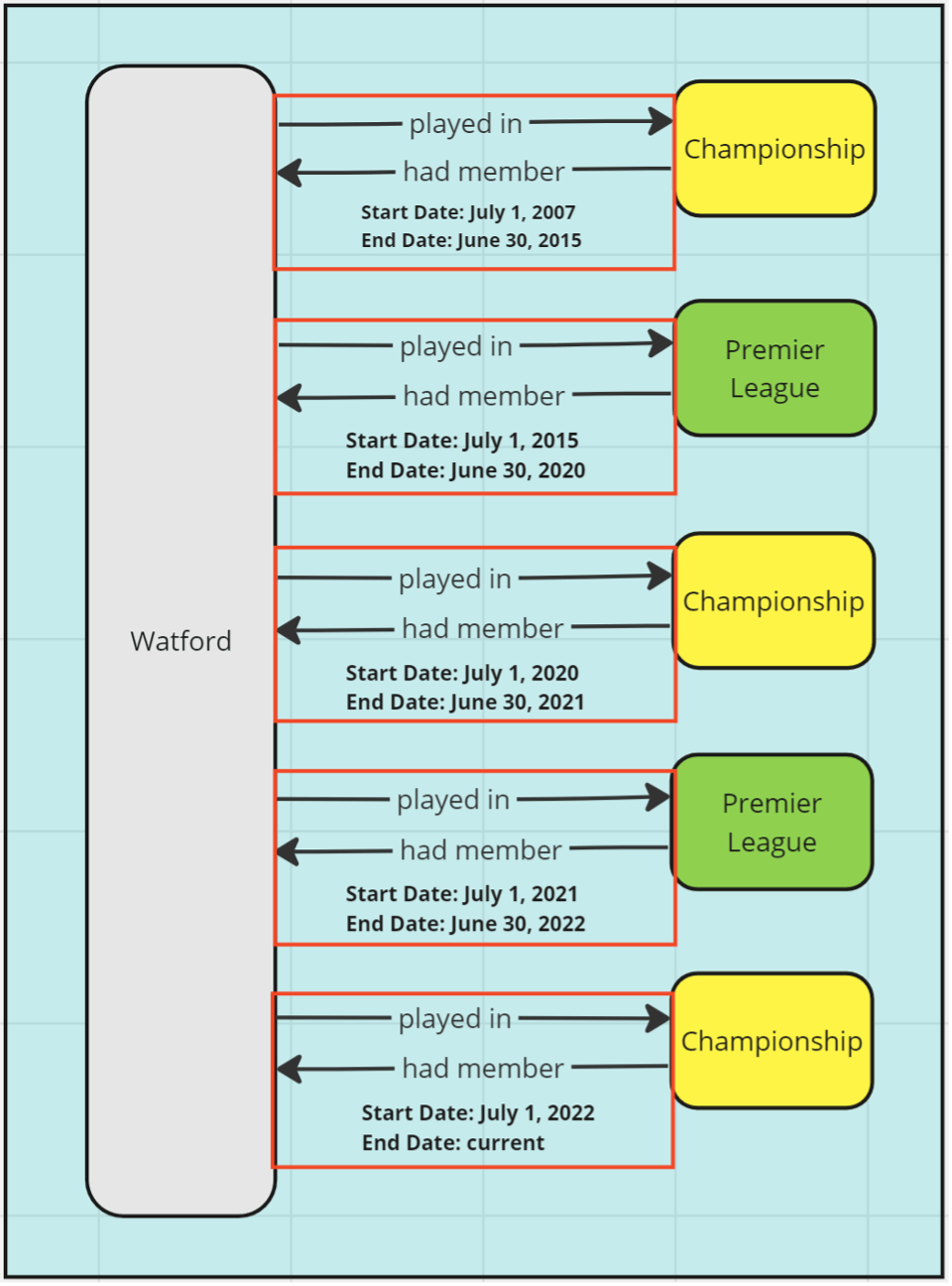

For our example, we’ll use a model for English Football. We’ll put together a simple model of a few clubs and the various leagues they played in over time. At the end of each season, a team may stay in its league, get promoted to a higher league or get relegated to a lower league. So, over time, a team bounces between leagues.
To model a team’s membership in a league, not only do we need to know which league it was a member of, but also how long the team was in the league. Using Watford F.C. as an example, this diagram models the team’s recent league membership history:
Before Semaphore version 5.8, each relationship had to be modeled as its own “data mapping” concept which contained the specific membership information, such as Start Date and End Date. This method, while accurately modeling the data, is cumbersome.
Because Semaphore 5.8 allows you to model the relationship information directly on the relationship, modeling through a “data mapping” concept is no longer necessary.

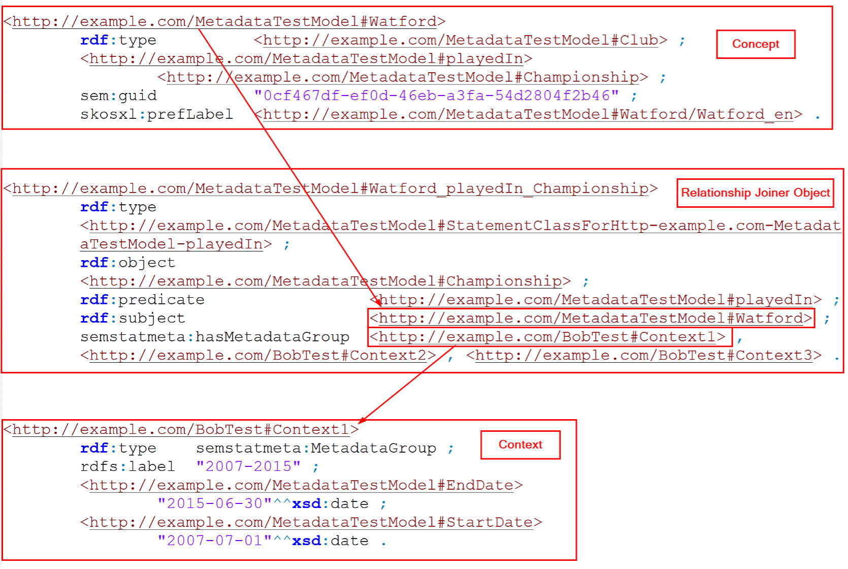

Accessing Relationship Metadata for Down Stream Use – The RDF Structure
Accessing the metadata on relationships is done via SPARQL (the current version of Semaphore does not publish metadata on relationships to either SES or the Concept Server).
The RDF for concepts, relationships, metadata properties and relationship types are constructed as in previous versions of Semaphore.
However, when the first Context is added to a relationship, a new joiner object and a new Context object are created. The joiner object links the concepts on both sides of the relationship to all the Contexts of that relationship. The Context object stores all the metadata on that relationship. Each new Context creates a Context object and adds its reference to the joiner object.

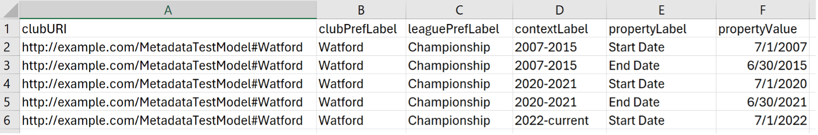

Querying for the Data with SPARQL
Although there is this additional join layer, retrieving the data in a simple, “unified” format is straightforward with SPARQL. The query just needs to be formed to pick up the data from the concept, the joiner and the contexts.
This is an example of a SPARQL query that can be run in the KMM SPARQL editor to unify and retrieve the data in CSV format:
