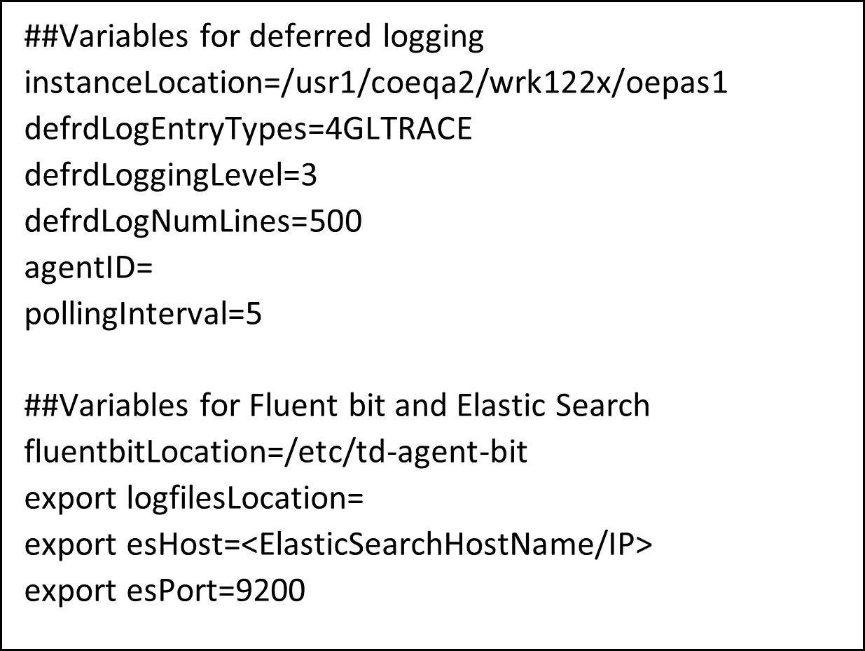

Download the attached zip file and then extract to a folder. Open config.txt file and then update the following values:
  • instanceLocation: PAS for OpenEdge instance location
  • defrdLogEntryTypes:
  • defrdLoggingLevel:
  • defrdLogNumLines:
  • agentID: PAS Agent ID. (You can get agent ID from tcman.sh plist command)
  • pollingInterval: Time in seconds, to flush deferred log entries from in-memory to disk
Sample config.txt file:
Once you update config.txt file, run deferredLogging.sh file which will take care of updating deferred logging entries in openedge.properties file, preparing a JMX query based on agent id and polling interval and then finally run the JMX query to fetch the deferred logging entries.
