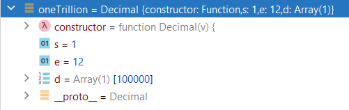

For example, we can see the internal representation in the decimal.js library of the first number below using a debugger inspector:
