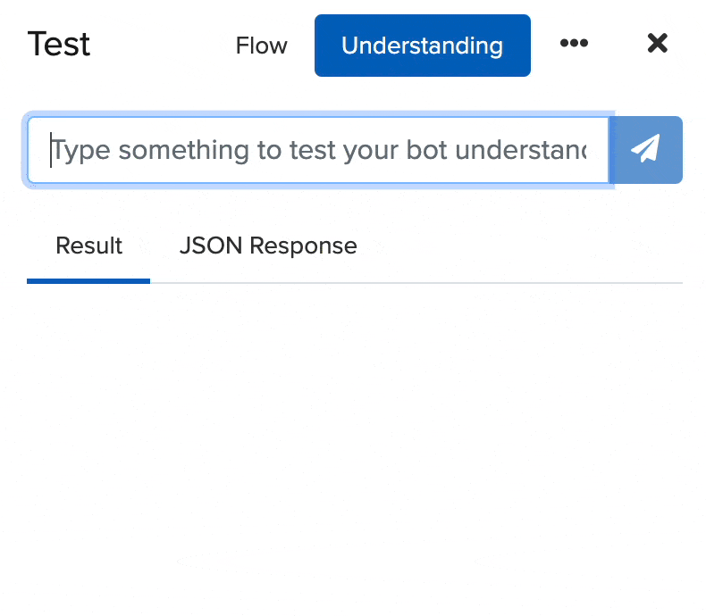

As we train our chatbot and provide it with new triggering expressions (which should trigger a specific response), it is good to test the new expressions as we go, and see what your chatbot would respond with.
NativeChat has a feature called Understanding, which allows you to test chatbot's understanding of various expressions. You can find it in the test window by switching to the Understanding tab.
To use it, just type any expression, press Enter, and NativeChat will respond with:
You can also use Understanding to see what Entities the chatbot recognises.

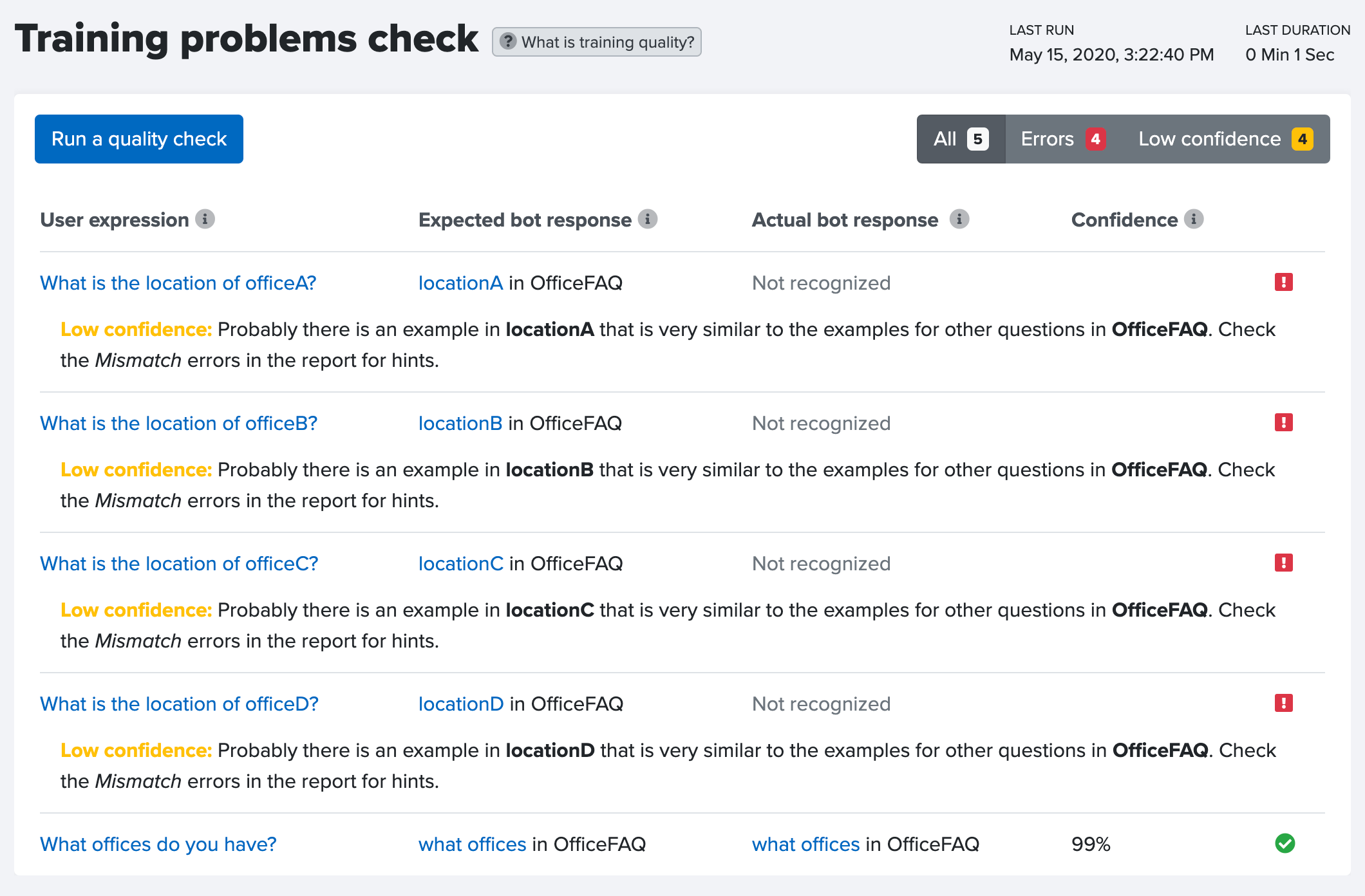

Sometimes, when we add a new conversation with a set of triggering expressions to our existing chatbots, it is possible that the new triggering expressions could interfere with other conversations. As a result of which, it is possible that adding a new conversation to our chatbot could make our chatbot not recognise conversations that used to work just fine.
It would be quite hard to manually test every conversation we have in the chatbot. However, NativeChat has a feature called Problems Check that allows you to test all the triggering expressions, and validate them against the conversations that were used to create the NLP Training Model.
You can find the Problems Check page by either:

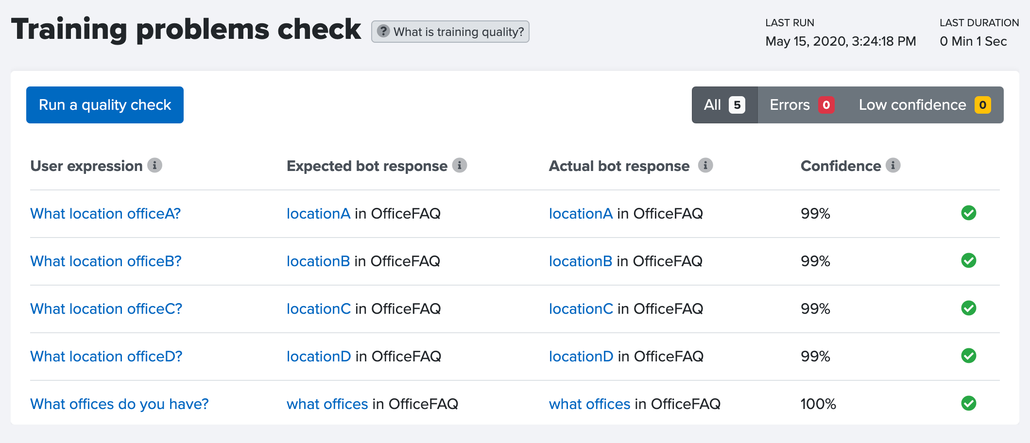

Then start the test by pressing the Run a quality check button.
For each triggering expression, you will see the expected conversation, the matched conversation, and the confidence level of that match. Like this:
Problems Check is a very useful tool to quickly check if any conversation doesn't get triggered as expected. This way you can identify potential issues, and make sure your user experience stays top-notch.
The Very Similar Triggering Expressions Problem
Sometimes, you might have multiple very similar triggering expressions, which are so close to each other that they fail to match even for exact matches.
For example, you might have four conversations with triggering questions like: "What is the location of officeX?"
When we run Problems Check against that set of triggering expressions, NLP will fail to match any of these four conversations.
This is because, in each case, NLP will match (What), (is), (the), (location), (of), and (?) tokens (words/punctuation marks). While the match to (officeX), will either be exact or too close for the NLP to decide which of the triggering conversations is strong enough to be returned as the correct result.
Let's face it, "What is the location of officeA?" looks very similar to "What is the location of officeB?".
The thing is that the only part that differentiates each of these triggering expressions is the name of the office. There are various ways in which we could use that to solve the problem at hand.
In the next three tips, we will see three different ways of solving this problem.

This is how you can update all failing conversations, and rerun Problems Check.
After we rerun Problems Check, all the triggering conversations should get a high-confidence match.
It is good practice to use the highlighting technique to tell your chatbots which words should be treated with more importance.

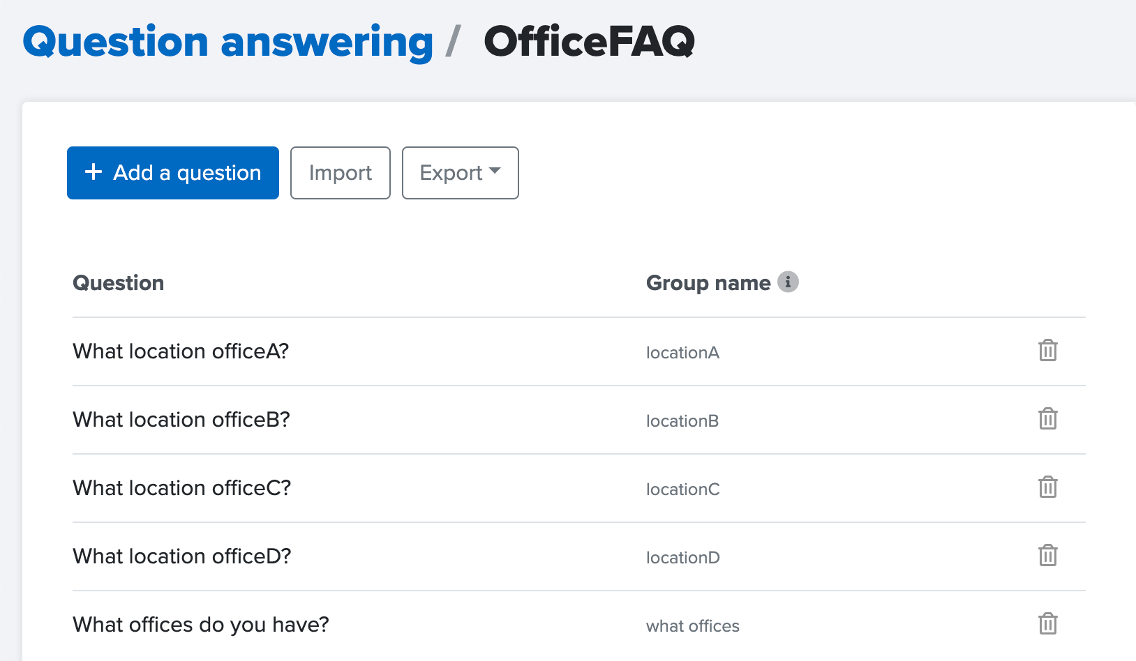

We can also improve NLP matching by looking at the Stop Words. These are words like: is, are, my, to, the, a, an, of. Words like that usually don't bring much value when it comes to NLP matching process. On the contrary, Stop Words tend to add more unnecessary variables.
Another way to solve the original problem could be achieved by removing the Stop Words (is), (the) and (of) from: "What is the location of officeX?". As a result, each expression should look like: "What location officeX?". Like this:
When we rerun Problems Check—note that we are not including the second expression used above for highlighting—we should once more get all successful matches like this:
Also, when we run the Understanding Test for: "What is the location of the officeA?", we still get a successful match to locationA, like this:
It is good practice to remove Stop Words from triggering expressions. This way we only keep the words that are useful for NLP matching, and as a result, we should expect more consistent results.

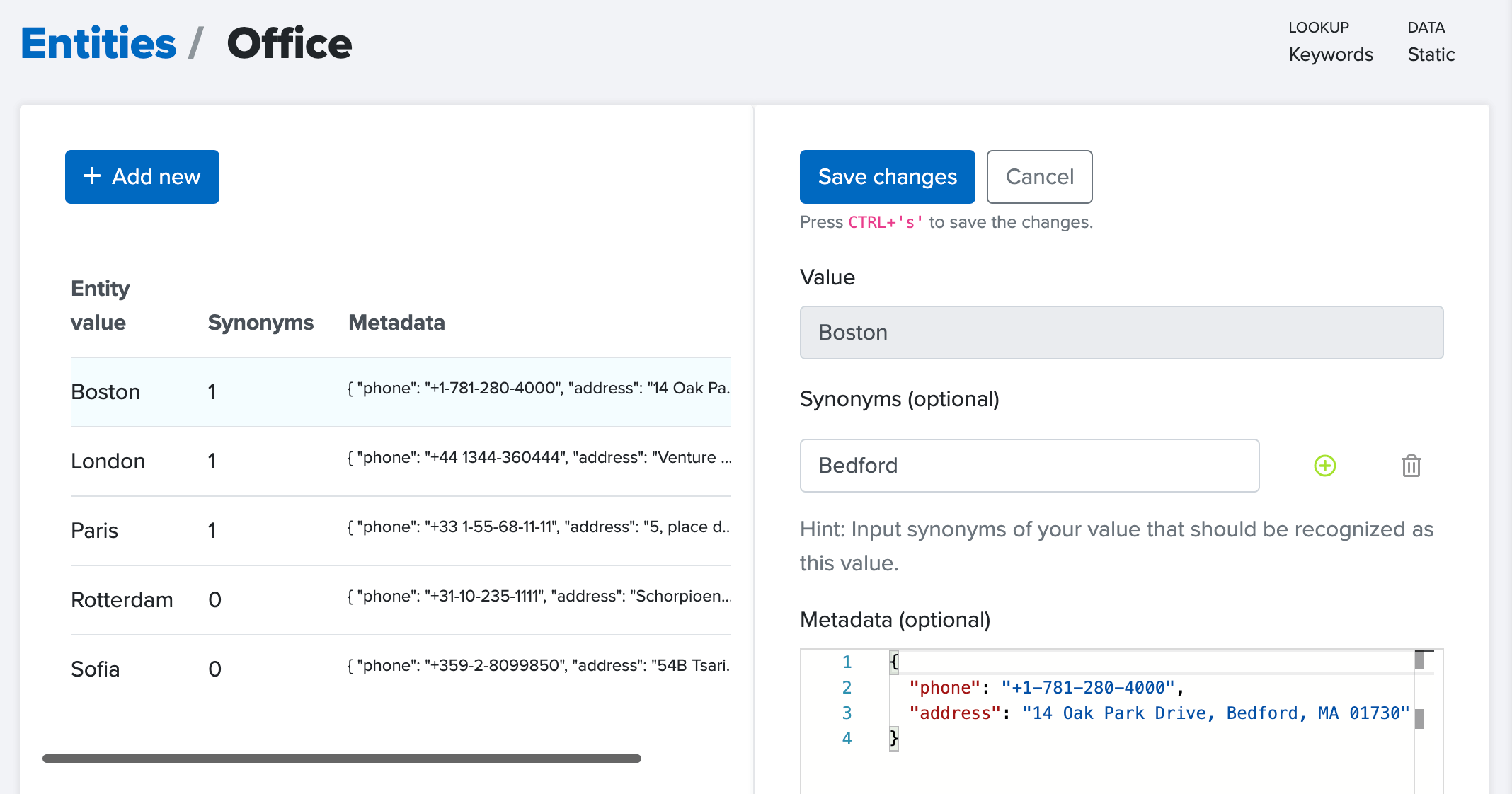

Step 1
Create an entity for the office. This is where we instruct what offices the chatbot should be able to recognize, together with attributes like address and phone number for each office.
Step 2
Create a new conversation in the Cognitive Flow.
This conversation has two jobs:

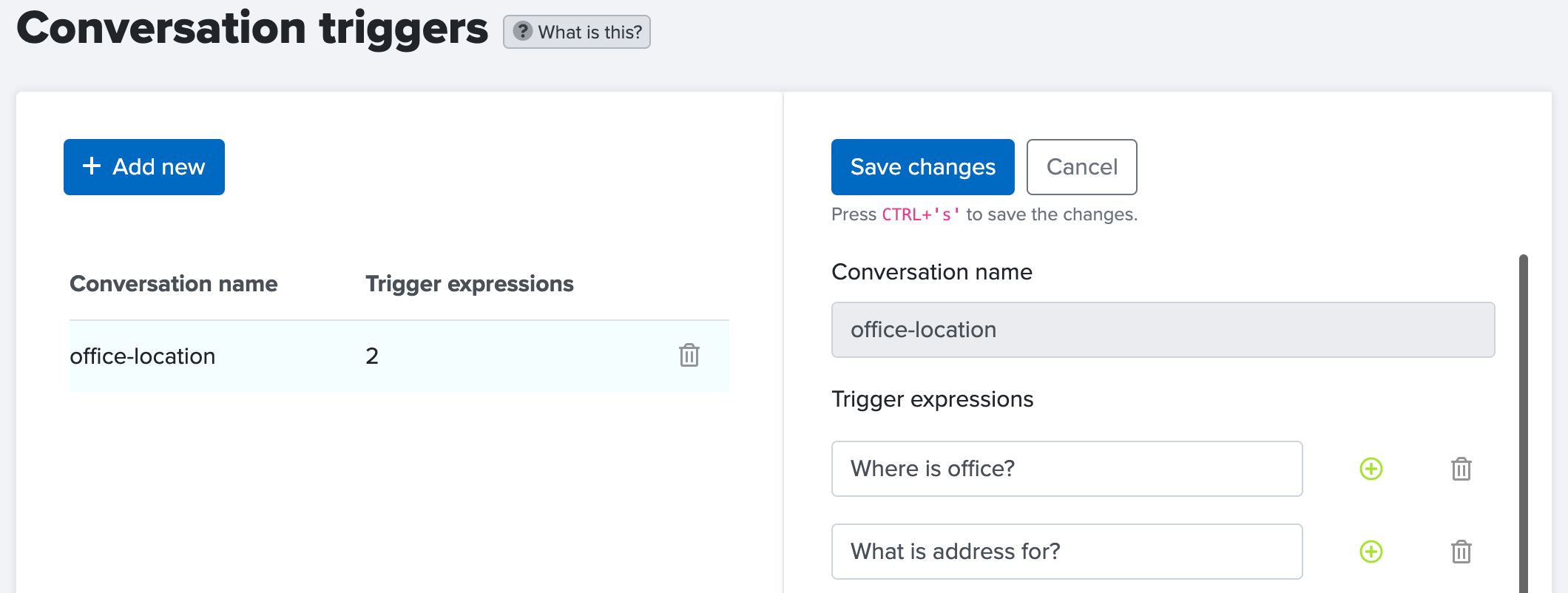

Step 3
Add conversation trigger, to tell the chatbot when to trigger this conversation.
We can use expressions like:
Step 4
And now we can test our new conversation, which should be able to handle both scenarios:
Like this:

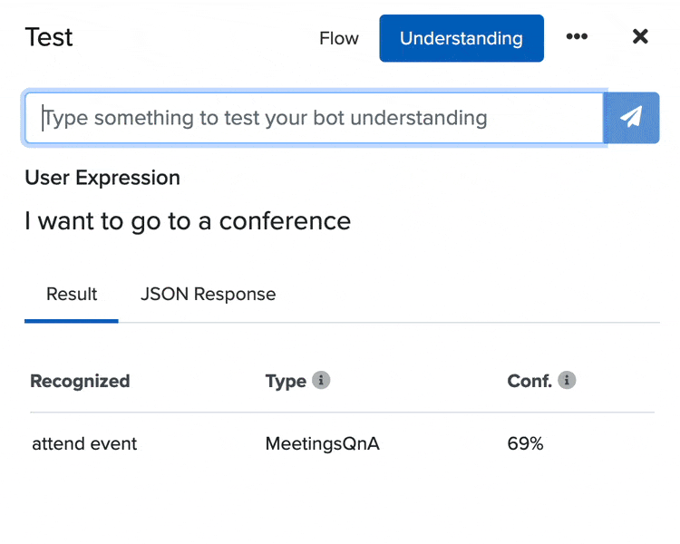

Tip #1—Test with Understanding
- the best-matched conversation
- the confidence score
Note, confidence above 65% means that the chatbot would accept that conversation as a valid match.

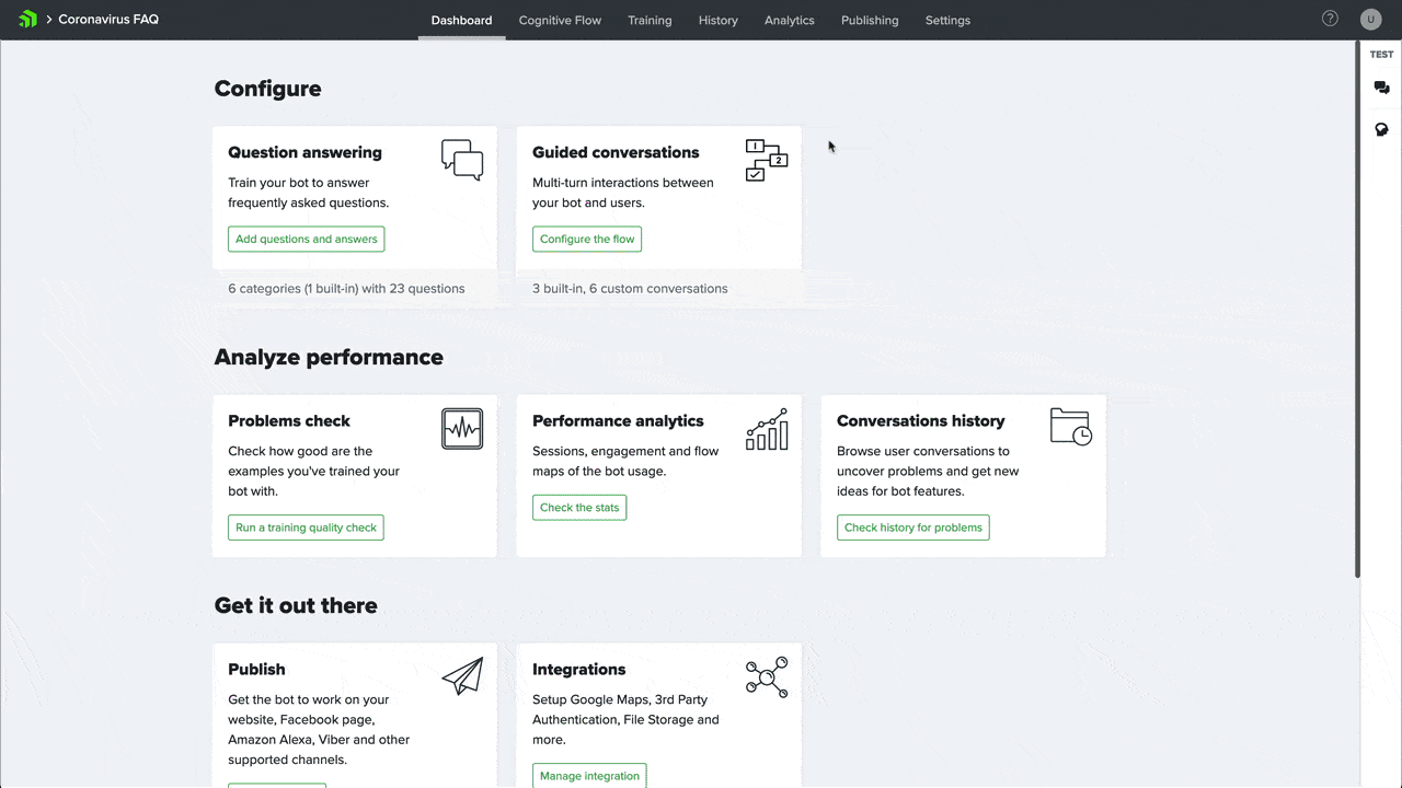

Tip #2—Run Problems CheckIt is good practice to regularly check the changes that we make to our chatbot's training, and make sure that we get the results that we expect.
- going to the Dashboard page and then navigating to the Problems Check page
- going to the Training tab and then choosing the Problems Check sub-tab

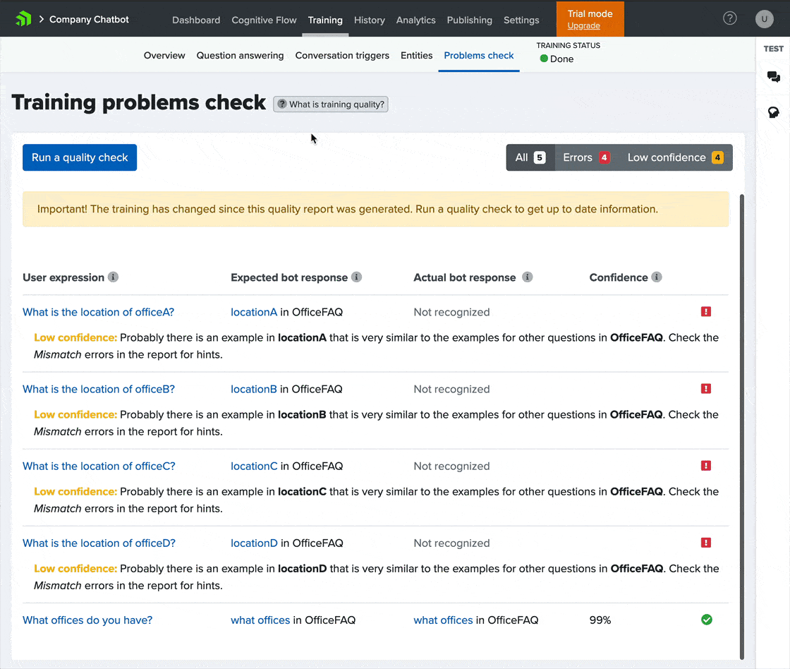

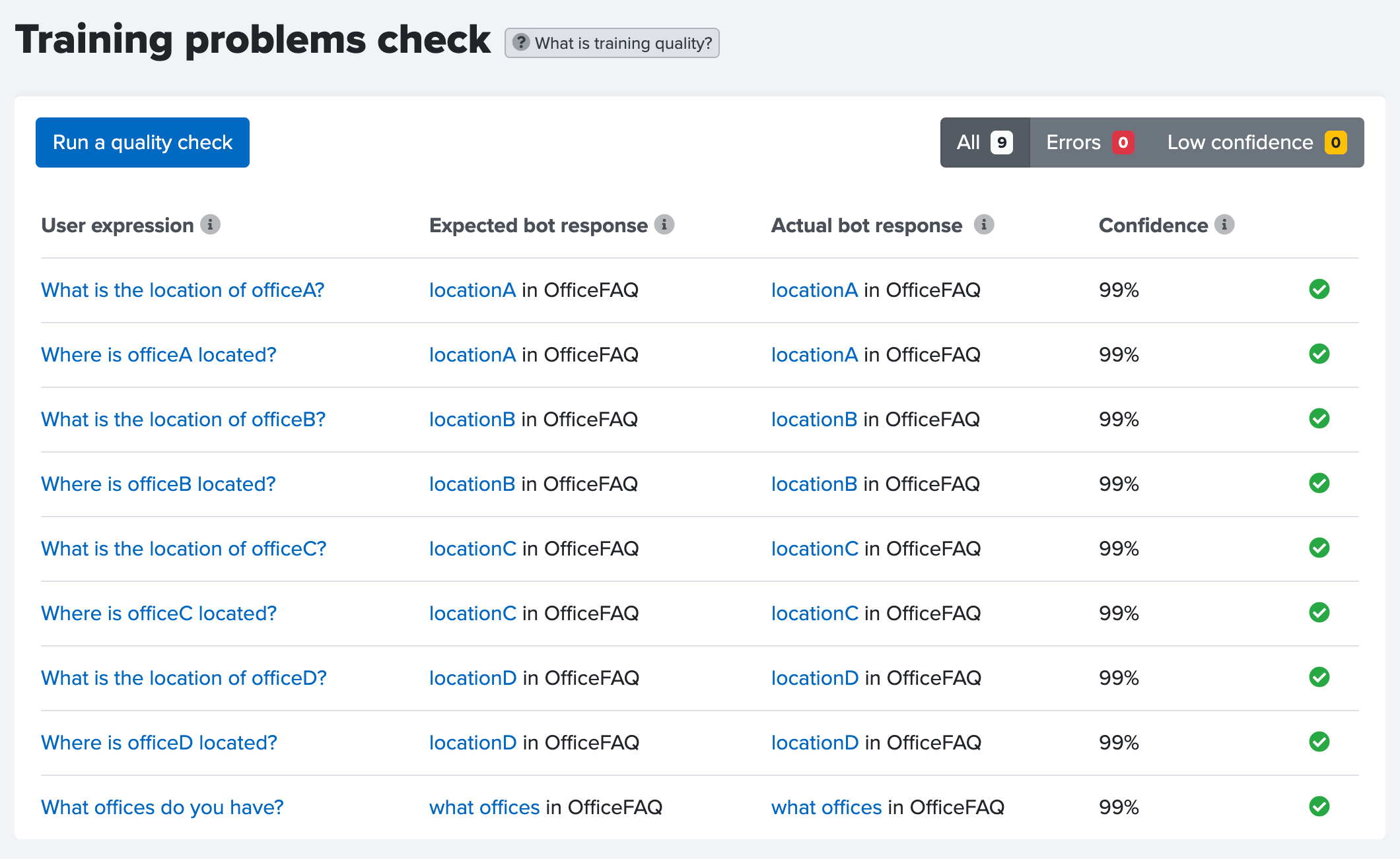

Tip #3—Highlighting Important Words
We could solve the above problem by highlighting more important words.
Highlighting is a technique in which we provide additional triggering expressions to the conflicting conversations. The additional expressions should contain the words that we want to highlight with the NLP as more important.
"If the word is so nice, you should say it twice."
In our example, we need to add more importance to the officeX name. This can be done by adding a second triggering expression to each conversation, which would repeat the name of the office, like: "Where is officeA located?"
This way, NLP will understand that officeA is very important, and it will prioritize matches to officeA above other matches.
This is useful both in the case where you have a lot of very similar triggering expressions, but also in general so that your chatbot will always understand what words it should pay special attention to.
Tip #4—Remove Stop WordsConclusion: Provide your chatbot with multiple expressions, to help the chatbot identify the keywords.

Here is how the code for a conversation like this looks:
"office-location": {
"type": "goal",
"steps": [
"type": "question",
"entity": "office",
"entity-type": "Office",
"messages": [
"Which office are you interested in?"
"display": {
"type": "quick-reply"
"type": "message",
"messages": [
"The address is: {{office.address}}."
- Where is office?
- What is address for?

Although building Guided Tasks requires more work up front, it makes it a lot easier to add a new office without having to change the flow of the conversation, and also it gives us a lot more control over the flow of the conversation.

Test
- Test often with Understanding
- Use Problems Check to test all triggering expressions
- Highlight Key Words—Provide multiple training phrases
- Remove Stop Words—Make expressions concise
- Convert similar Q&As to Guided Tasks
