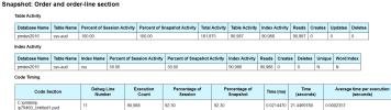

OK, now in a new session it's just giving me an empty HTML table for Code Timing.
The pattern of lights is all wrong... Refilling my coffee...
Rob Fitzpatrick
I think this is the relevant code in the PUT statement in the WriteHTML method:
'<td>' STRING(ttSnapLineSummary.TotalTime / 1000,">>>,>>>,>>>,>>9.9999999") '</td>'
'<td>' STRING(ttSnapLineSummary.TotalTime,">>>,>>>,>>>,>>9.9999999") '</td>'

Thanks... I am in the process of changing all of the TT columns to say MS or Seconds instead of time and getting rid of all the calculations that are happening in the GUI/HTML side.
Looks like I had a slightly different version than the last upload on my PC. I need to implement some kind of version number in the various programs and get my SVN server going again.

Looks like some of the timing displays are messed up in the HTML/GUI side (new versions should correct this I hope).
You can grab it again from http://themaddba.s3-website-us-west-2.amazonaws.com/dlmain.html
