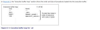

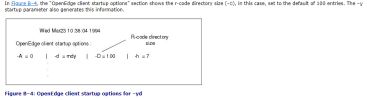

My question about R-code execution environment statistics.
how we will use the -y and -yd parameters.
