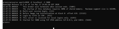

I tried to delete the test database "sports2020" via proenv and created a new one with a different port (before: 9999 as recommended during the course, after: 5000 as recommended from some guys from different communities) but it didn´t helped out.
One thing I noticed during renewing the database.
In proenv there was the line after creating the new database which I didn´t see during my course:
"This server is licensed for local logins only. (4393)"
After that the port 5000 as well as the IPV$ 127.0.0.1 with pid 14832 was shown correctly. Screenshot attached.

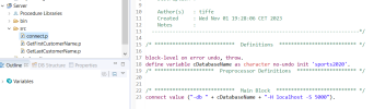

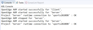

In your connect statement you have:
connect value( "-db " + cDatabaseName + "-H localhost -S 5000" ).
At runtime that will become connect "-db sports2020-H localhost -S 5000".
Note that the lack of a space before "-H" causes that parameter name to be concatenated to the database name, causing the runtime to see "localhost" as a parameter name rather than a -H parameter value. Put a space before "-H" in your connect statement and see what happens.
