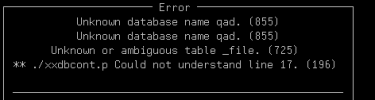

Shubhrant
I tried the below query.
define variable m_db as character no-undo.
update
m_db with frame a side-labels.
create alias qad for database value(m_db).
for each qad._file where _file-name = "xx_gvs_det" no-lock:
disp qad._file with 2 col width 200.
end.
In this case i am getting the below error...
RealHeavyDude
Well-Known Member
The _File like other meta-schema tables without the logical database name is only valid for the DICTDB. That is a special DB alias that usually points to the first database connected in the session. The reason is that these meta schema tables are present in any Progress database.
You need to use the logical database name ( which is usually specified with -ld on the connection parameters ). Any alias you create should point to a logical database name for an existing connection. If you just provide a field where somebody can enter an arbitary string you either must know which databases are connected and what logical database name the use. I would use a selection list instead which I would populate from the connected databases.
