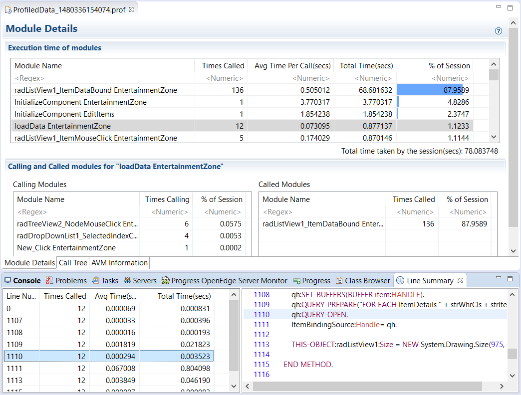

A new tab called “Profiler” was introduced in Run Configurations. Once you are done with coding, if you want to profile your application, all you need to do is to launch “Run Configurations” and run the application by choosing the “Enable profiling” check box. This will generate a .prof file which will be opened in the “Profiler Viewer” as soon the execution of the ABL program is done. This profiler viewer is a multi-tabbed viewer which displays the profiled data.
The first tab in the view “Module Details” will provide high level information on the execution time of the modules along with the details on number of times they were called, the average time and the line summary. Also there are details on Calling and Called modules for each module.
