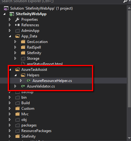

In the root of your Sitefinity project, create the following folder structure:

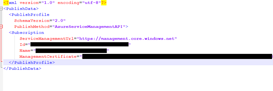

For this class there are three important properties that need to be added. The first is AzureMode, which is an Enum of two items (AppServices, CloudServices). The second and third need information from the Azure Publish settings file (remember that from earlier?): SubscriptionId, CertificateData. Open the file and you should see something like the following:
Copy the values from Id and ManagementCertificate and paste them into the SubscriptionId and CertificateData properties respectively. Once done your properties should look like this:
