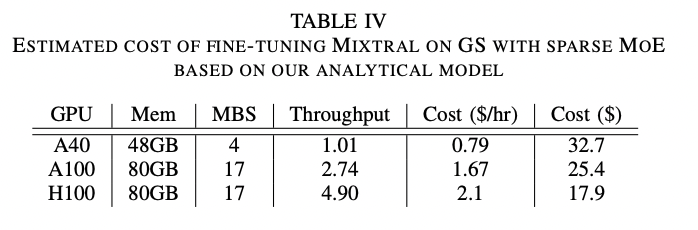

The Hidden Costs of Fine-Tuning
Let’s talk numbers for a second.
Beyond the direct training costs, fine-tuning brings hidden expenses that add up quickly. Even the research models this out: in one published analysis, fine-tuning a Mixtral-class model on a small dataset costs as little as $18–$33 depending on the GPU used, but scaling that same workflow to a realistic enterprise dataset (around 2 million queries) pushes the cost to roughly $3,460 on an H100.
And that’s just the compute bill. It doesn’t include the hours your team spends preparing data, testing configurations or retraining when requirements change.
Data preparation alone can consume weeks of engineering time. You need to clean your datasets, format them correctly, remove noise and verify quality. If your data isn’t already structured for training, you could be looking at a significant upfront investment before you even start the fine-tuning process.
There’s also the opportunity cost. While your team is focused on managing fine-tuning workflows, they’re probably not building new features, optimizing customer experiences or solving the next business problem. In fast-moving markets, that delay can matter more than the dollar amount.
And if the model doesn’t perform as expected? You’re back to square one, except now you’ve burned budget and time with nothing to show for it. Unlike RAG, where you can test and iterate quickly, fine-tuning failures are expensive lessons.
RAG avoids most of this. The setup is faster, the iteration is cheaper and the results are immediately testable. You’re not locked into a multi-week training cycle just to find out if something works.
