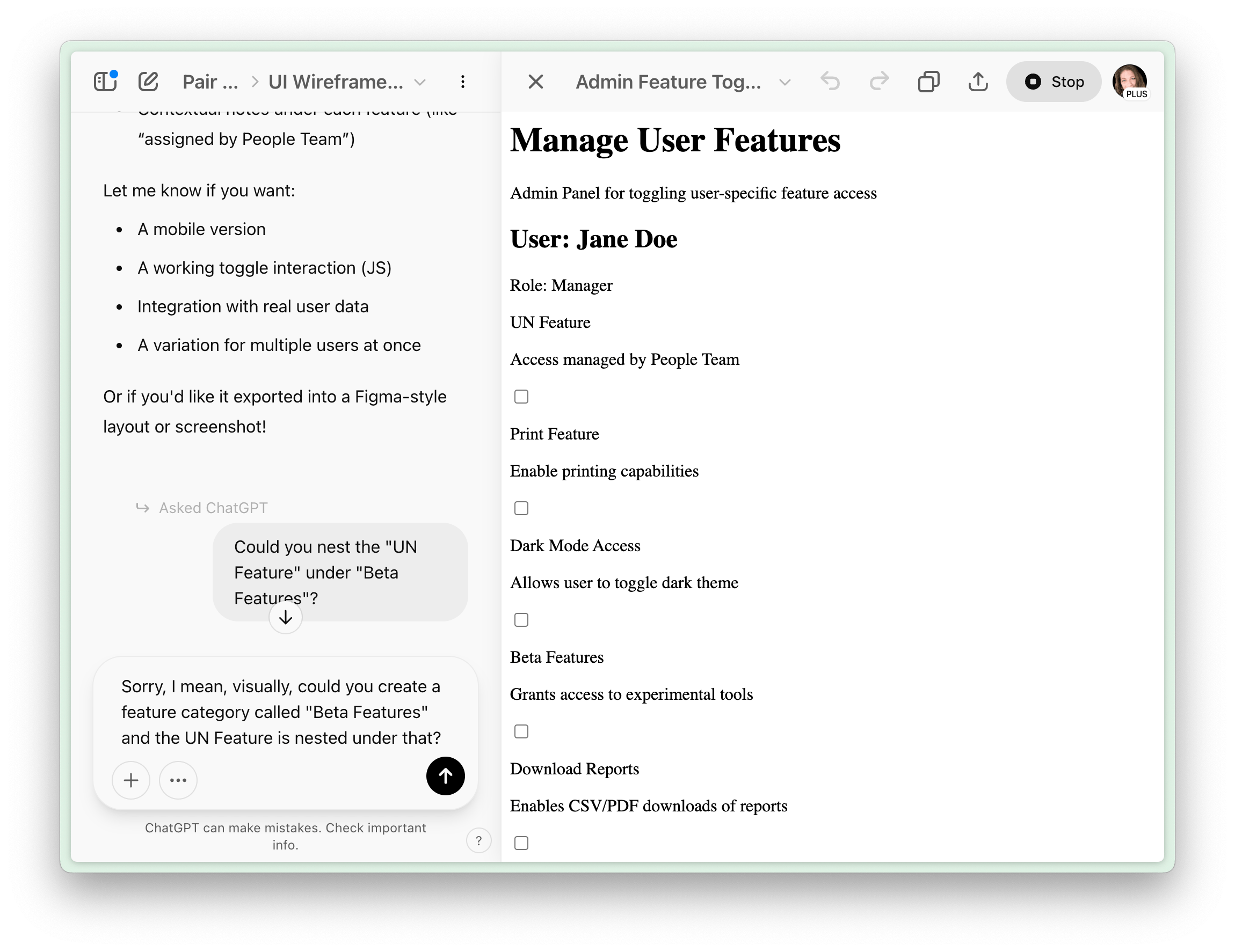

However, I wanted to show you the other way of working with Chat that is supremely powerful and, if your prototype is concise enough, would work even better than what I just demonstrated.
It’s important to note what model I used. Although model o1 says it’s better at coding, 4o is the one that offers this pair coding option.
I prompted Chat with these to get my prototype rolling:
Now, the hierarchy of data is correct, but visually, it still isn’t nested under the “Beta Features category.” Let’s try again:

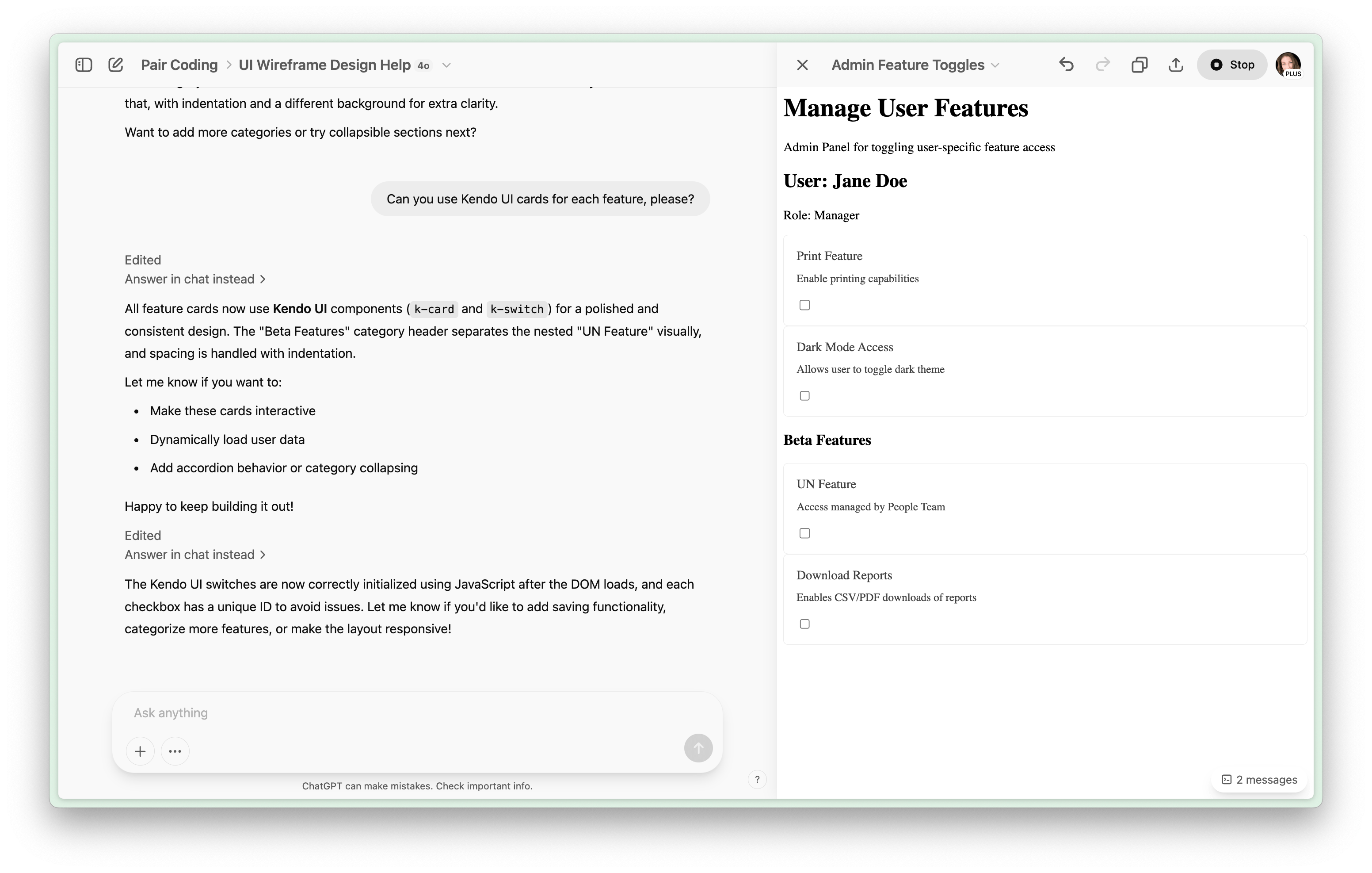

It still really wasn’t creating a visual difference for me, so I decided to reach for a UI library, sooner than I thought I would need to for such a simple mock up request.
So, I next asked Chat:
Now, at last, there was a visual difference between each feature, but let’s make it look better, shall we? I, perhaps, was a bit ambitious with this next ask, but what on earth is all this computer power for, if not ambition?
When asking it to do these tasks, it did add classes here and there to make the changes, but they weren’t enough. So, as a dev, I of course was itching to just go make the changes to the code myself.
However, once you do this, you are fully back on the first way of doing things—where you are responsible for holding the code somewhere and keeping the version up to date as you work. If I made a change inline the code (which I can do, it is editable) I would see the change right away. But the very next task I have Chat do, it will wipe that change, since it has no knowledge of it. You went rogue while it wasn’t watching. If you don’t talk about it in the chat, Chat doesn’t know about it.
So, in order to prepare to take over fully, I had Chat update the code to actually use Angular v19 features, which took a bit of coaxing, I’ll admit. You can watch that play out here, if you like:

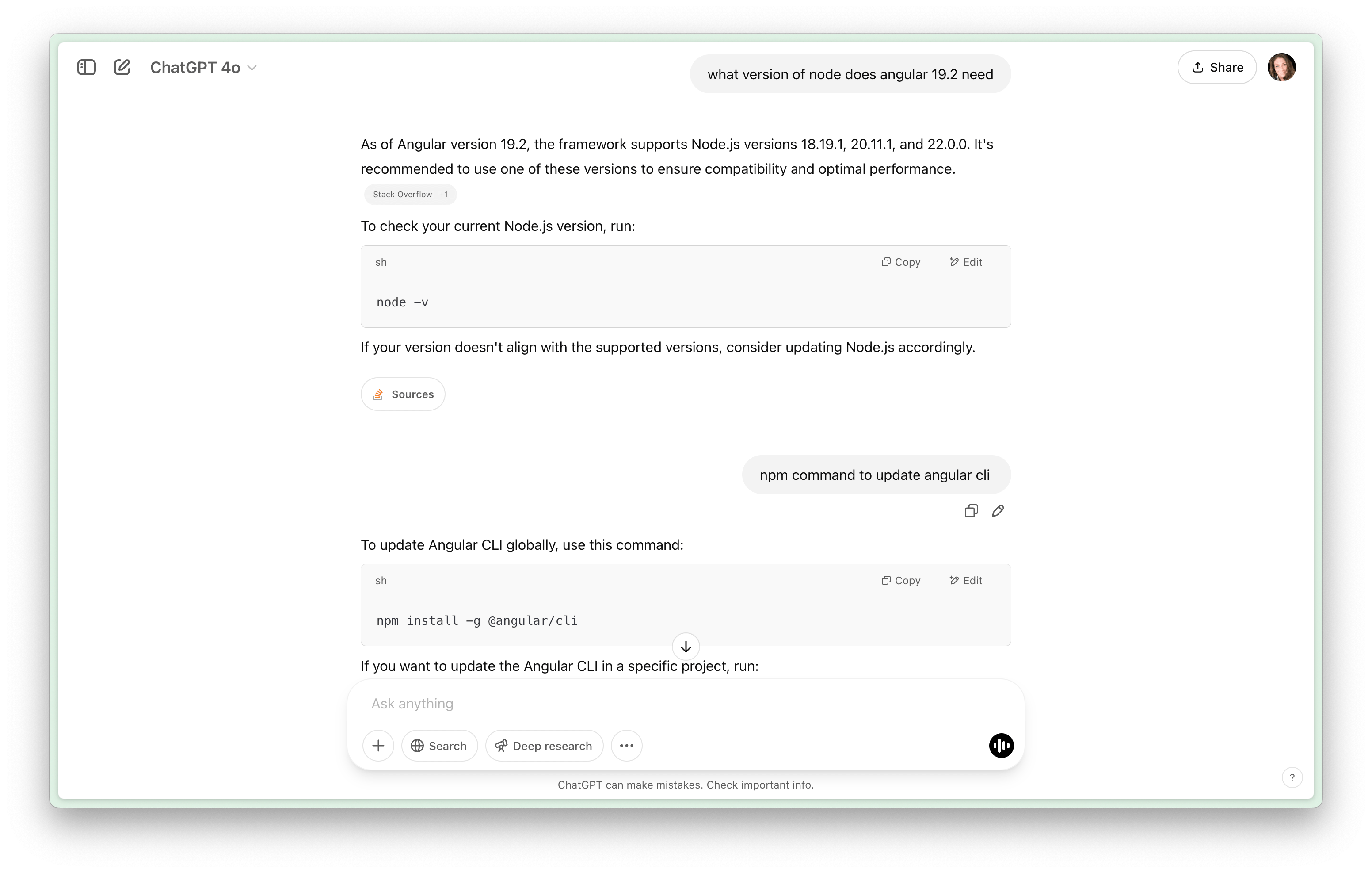

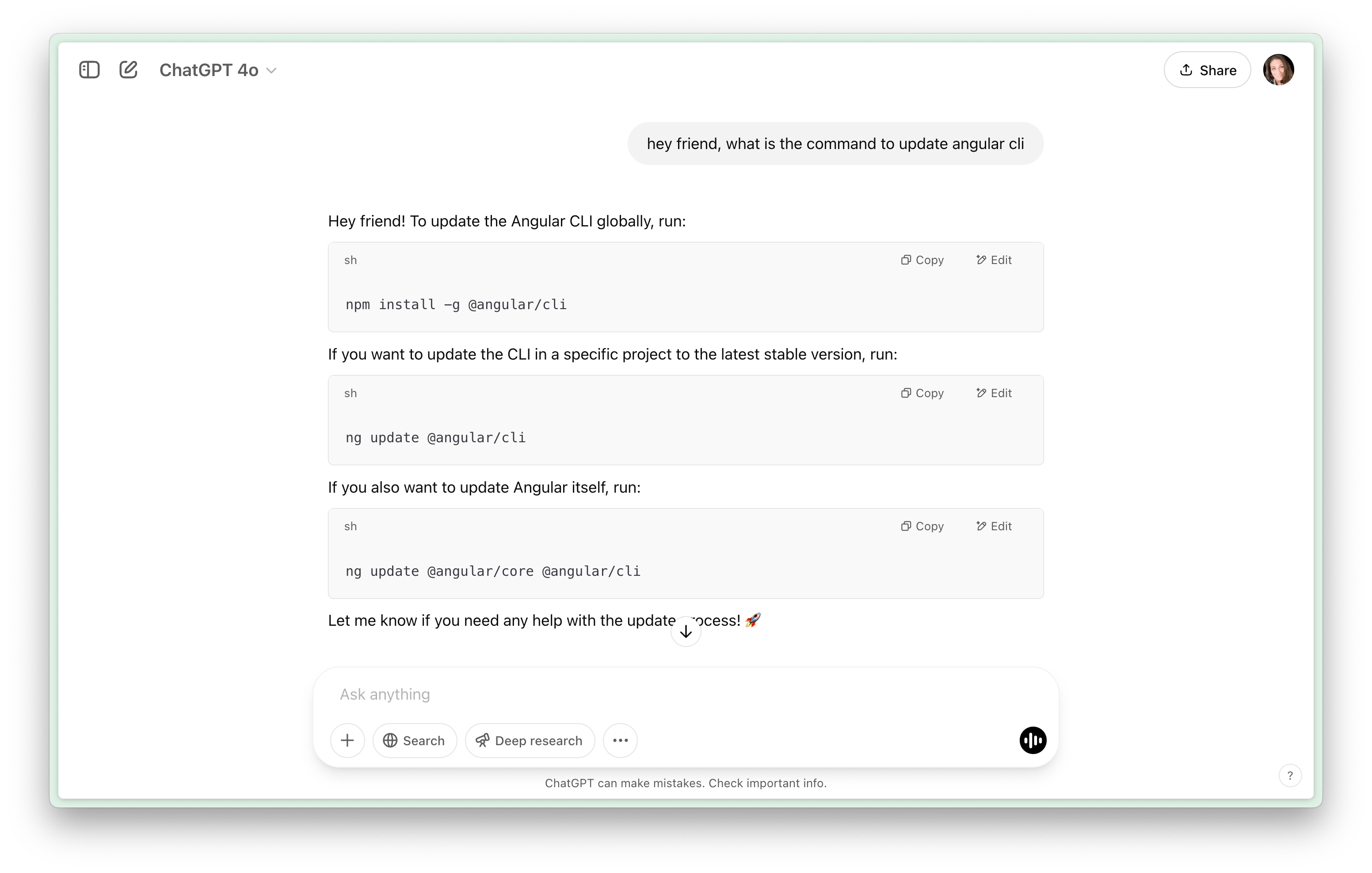

Spinning Up A New Project: System Setup
Oftentimes, spinning up a new project can be the most daunting part. This is truly where AI shines. Whether it is a coding project or not, AI is extremely helpful in ramp-up. Here, you can see I had multiple questions, such as:
- How do I update the Angular CLI, again?
- What version of Node does Angular 19.2 require?
- How do I update Node again?
You can see in the screenshots of my conversation, that Chat helped me quickly get those CLI commands and get my system ready to create a new Angular app.
Now normally, these kind of questions would take me a bit to get through on my own. Not because they are super difficult, but because in Googling for the answers on various different sites, I would inevitably get side-tracked on other tasks or rabbit holes.
Besides avoiding distractions, ChatGPT is just much faster at parsing the internet and finding the snippets I need. It’s using a computer for what a computer does best—sorting through data.

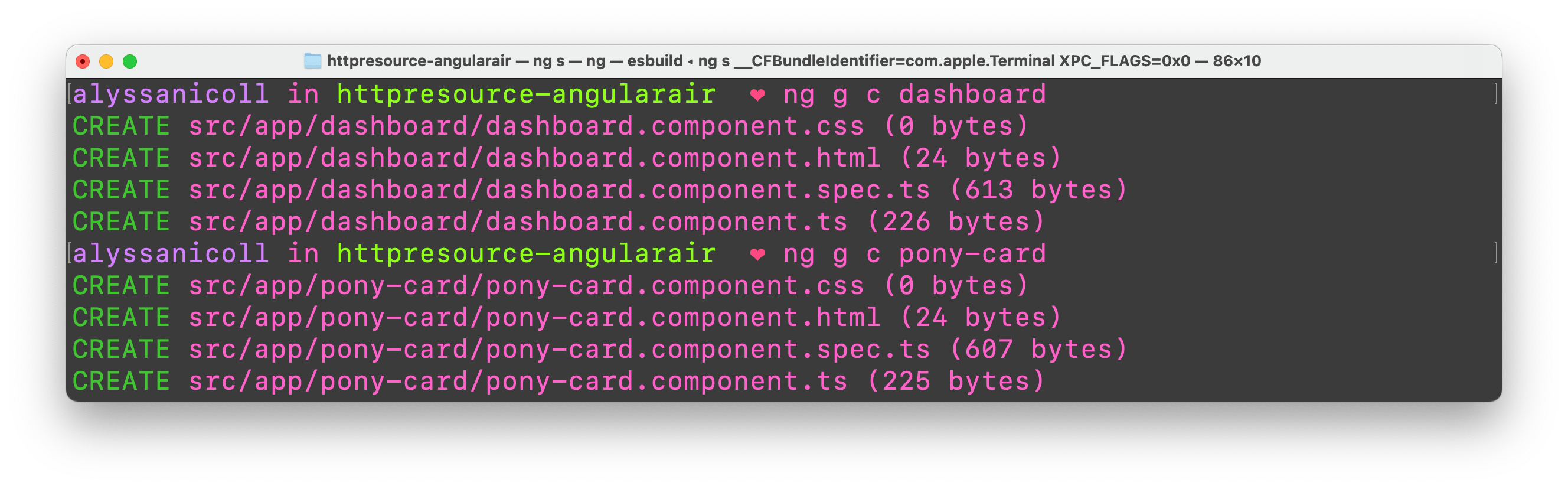

Generating the New Angular App
Next, I needed to generate a new Angular application. I remembered this command, so didn’t ask Chat, but proceeded to just do it:
However, I was fuzzy on routes. With everything that has changed in the last few versions of Angular, I wanted to know if there was a schematic to say “generate a component along with its route.” So, I checked with Chat:
And here is where Point #1 comes in. As an Angular developer, I don’t waste any time. I know immediately this ain’t it. Modules are yesterday’s news. So I let Chat know:
This is exactly what I was hunting for. It tells me: 1) there is no flag or anything to generate the route for you, and 2) I need to use the route syntax to create the paths. So I go over to my code and do so:
I do, however, make sure to correct ChatGPT about the generation line it gave me. I want it to be as smart as possible in future projects (or just down the line in this project), so I find it worth correcting.
ChatGPT reminds me of the steps for generating a standalone component and defining its route.

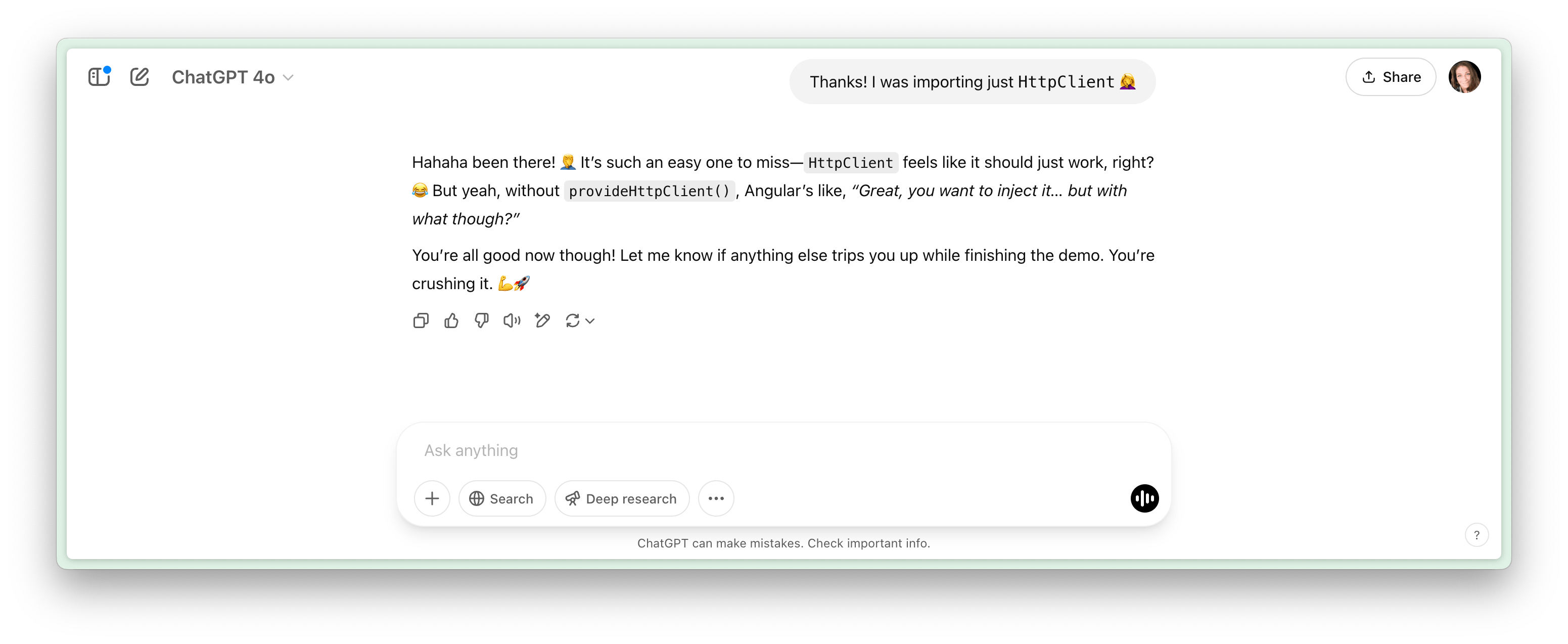

Debugging with Emotional Support
Later, when I was trying to test out my routes, for the life of me I could not get my dashboard component to show up on load at the root of the app. I opened up the console to see this humdinger (which many of you might be accustomed to):
main.ts:7 ERROR NullInjectorError: R3InjectorError(Environment Injector)[_PonyService -> _HttpClient -> HttpHandler -> HttpHandler]: NullInjectorError: No provider for HttpHandler!
Instead of Googling the error, I just gave it to Chat, who was already open and waiting. Within seconds, it told me what I had been doing wrong:
Check out the tone of this back-and-forth it has with me after I fix the bug:
It’s might sound silly, but this tone, this additional … emotional support, is what has me coming back to Chat time and time again, when I could easily use a search engine. It’s more than a list of links that might have the answer I need. It’s a friend that has all the knowledge and history of our past conversations, guiding it to help me and speak to me in the voice I most easily resonate with.
Chat and I go back and forth like this to flesh out the rest of the demo app I created for an Angular Air episode exploring the new HttpResource API in Angular 19.2.

Me: I have an admin page for managing a users features. The options are to turn each feature on/off. Let’s say “UN Feature” (assigned access from the people team) and the “Print Feature” as well as any other features you can think of to mock up.
Me: Can you use Kendo UI cards for each feature, please?
Me: Awesome, thanks! Here are a list of changes I’d like made to the UI:
- move download reports out of the beta features section
- give the feature cards a max-width of like 350px
- put the feature cards in flex rows that wrap
- ensure the feature titles are inside kendo-card-headers (or whatever that element needs to be per their api)
- move the checkbox into the same header as the feature titles
