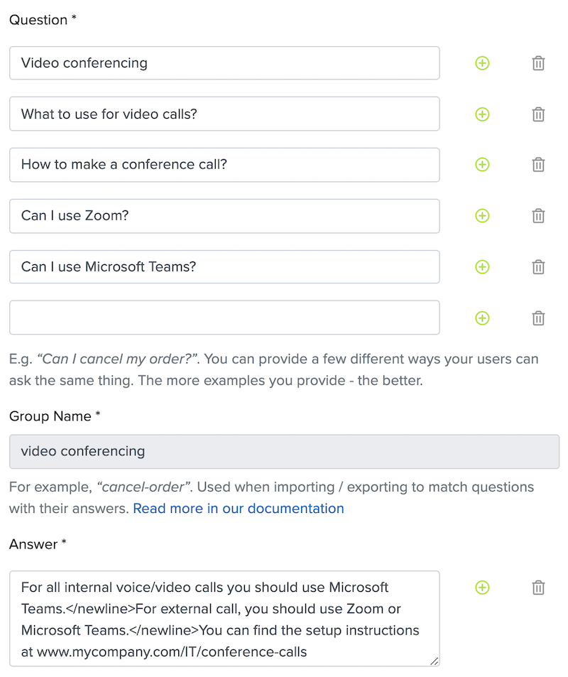

Step 1 — add a new Q&A
From the MeetingsQnA category, press the + Add a question button.
Add the following questions:
- Video conferencing
- What to use for video calls?
- How to make a conference call?
- Can I use Zoom?
- Can I use Microsoft Teams?
Note: It is best for the first question to be short and generic.
This is because when you ask the chatbot to give you a list of available question it uses the first entry for each Q&A to display the options.
Set the Group name:
- video conferencing
Set the following answer:
- For all internal voice/video calls you should use Microsoft Teams.</newline>For an external call, you should use Zoom or Microsoft Teams.</newline>You can find the setup instructions at www.mycompany.com/IT/conference-calls
Your new Q&A should look like this:
Finally, save the changes by pressing the Save changes button.

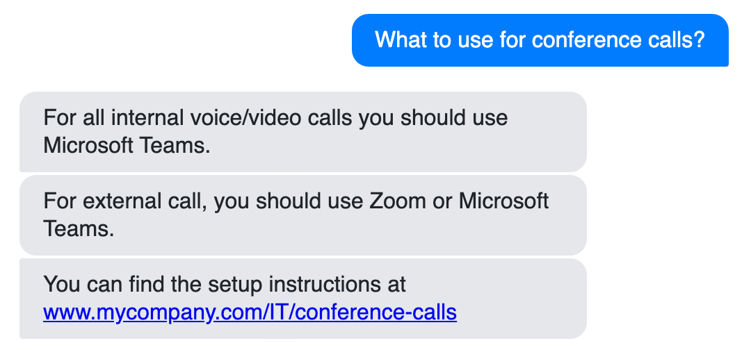

Step 2 — test the new Q&A
Now, you can test the new Q&A by saying:
- What to use for conference calls?
- Can I use zoom?
Your chatbot should respond with:
