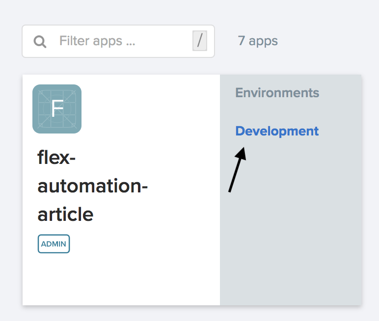

Kinvey Console
Start by creating a Kinvey app and a Flex Service using the Kinvey Console. First, log in to the Kinvey console using your Kinvey account and create a new application. We will call our app flex-automation-article. Then navigate to Service Catalog from the upper left corner and add a new service. It needs to be a Flex Service with Flex Services Runtime. You need to give it a name such as flex-automation-article-service and choose the app you just created to allow it to access the service.
