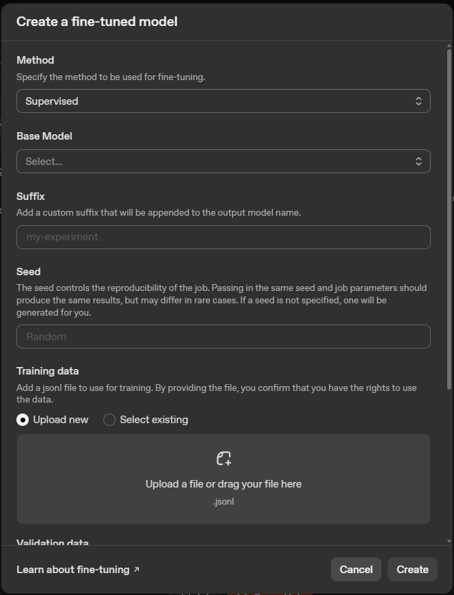

Next, you can head over to the OpenAI fine-tuning portal, where you need to click on the + Create button, which will show you a window like the following:
In the previous window, the available options are:

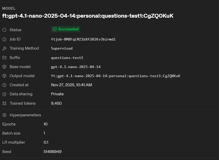

With the previous information ready, just click the Create button to start creating the fine-tuned model. It is important to note that in case there is any issue during the process, we will be notified immediately, showing the cause of the error so that we can fix it, as shown below:
On the other hand, if the training was successfully executed, we will see information about the new model as shown below:

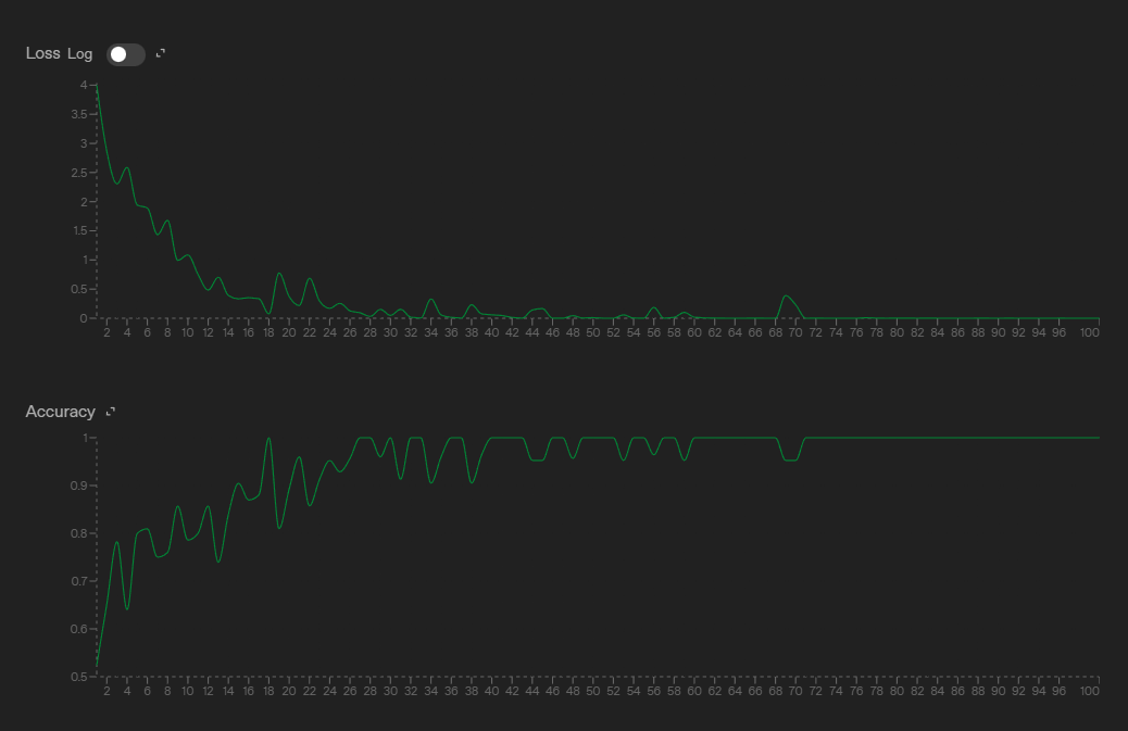

Some other interesting data that we will see in the interface is that we have a set of checkpoints, which are copies created during training at certain moments and are usable for testing, in addition to some graphs that show Loss and Accuracy:
In the previous image, we see how Loss decreases, which means that the model is improving in terms of prediction, enhancing its responses as training progresses. On the other hand, Accuracy is increasing, which translates to the model making fewer mistakes, providing correct answers more frequently as training advances.

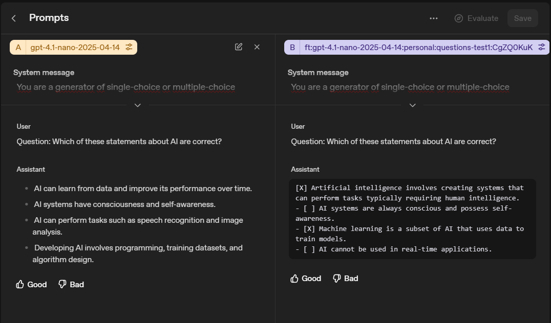

Once we have the new model ready, we can test it in the playground:
In the previous image, we see a response generated by a general-use model on the left, while on the right, we see the response generated by the fine-tuned model, showing the correct format according to the training data.
- Method: Select among the methods Supervised, Direct Preference Optimization or Reinforcement fine-tuning, which we have already discussed earlier.
- Base Model: The base model to be used for fine-tuning.
- Suffix: A suffix that will be added to the model's name, which will help you identify the training.
- Seed: Allows you to specify the randomness of a training session so that it can be reproducible.
- Training data: This is where you select the JSONL file with the training data.
- Validation data: Allows you to specify a JSONL file to validate how well the model is learning.
- Configure hyper parameters: These are adjustments you can select for the training process, including the number of examples used before updating the weights (Batch size), the speed of weight adjustments (Learning rate multiplier) and the number of times the model goes through the dataset (Number of epochs). These can be left on auto for the platform to decide the best values.
