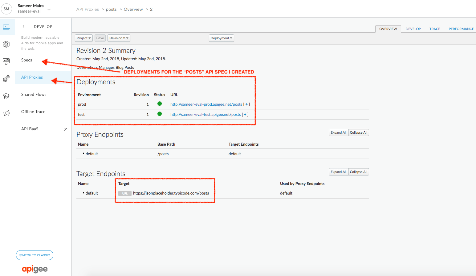

Apigee Edge Proxy
For my setup, I created a spec in Apigee for an endpoint called “posts” representing blog posts. I then created an Api proxy and attached it to an actual backend REST API endpoint “/posts” served using JSONPlaceholder. Apigee can deploy the proxy to a test/prod environment each of which has a url which can be configured in the Kinvey RAPID Connector. The URL I got for my posts spec proxy was http://sameer-eval-prod.apigee.net/posts
Now let’s look at how I intend to wire everything up with Kinvey. Pretty straightforward.
