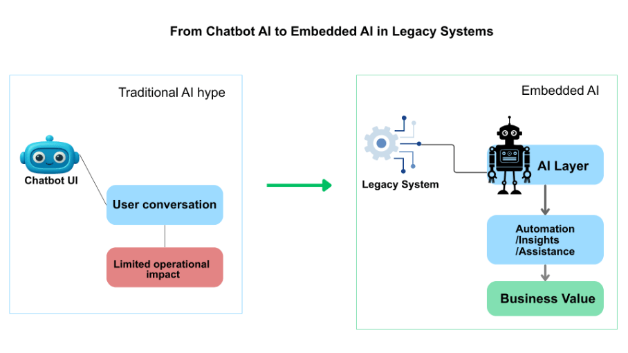

Don't get me wrong. When I started exploring Large Language Models (LLMs), the chatbot felt like the ultimate epiphany. It was the most visible, most demo-able thing you could show a client. But after years of bridging the gap between AI research and production reality, I’ve realized that for most enterprise organizations, the chatbot is not actually what we can always need (I know, it’s hard, perhaps).
I’ve spent a lot of time in environments where the software isn’t shiny or new. I'm talking about legacy monoliths, ERPs that have been running since before some junior developers were born and databases so complex they feel like archaeological sites. In these contexts, adding a chatbot is often like putting a fresh coat of paint on a house with a broken foundation. It looks nice, but it doesn't solve the structural friction.
So, how do we integrate GenAI where it actually matters? If you’re sitting on a mountain of legacy code, maybe a Java monolith or an old .NET setup, I’ll discuss in this article the three ways to use AI that have nothing to do with a chat window.

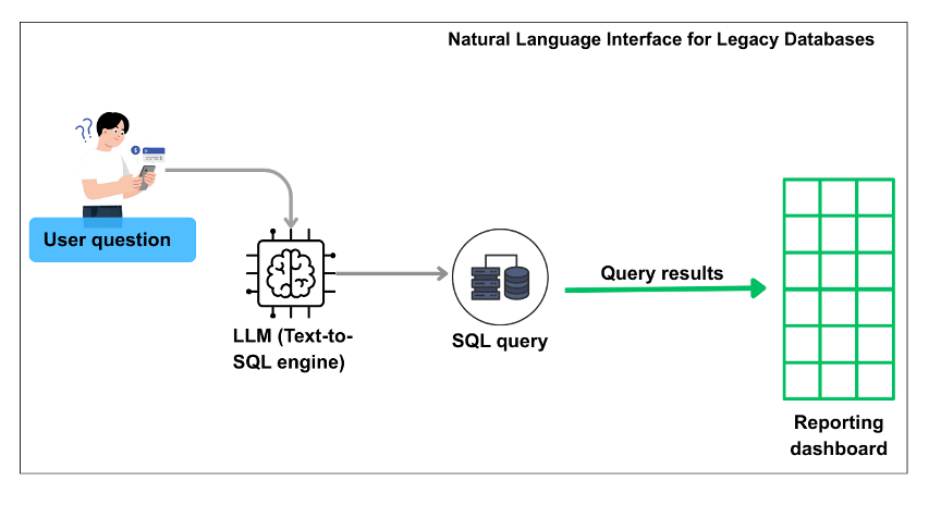

One of my biggest "lessons learned" came from a project with a logistics firm in Kinshasa. They had a massive SQL database, the kind where a single report required joining 15 tables with names like T_TRX_99_FINAL. So, for a non-technical manager, getting a simple answer like "Which orders have been stuck in processing for more than 48 hours?" was a two-day ordeal involving a Jira ticket and a tired DBA.
Early on, I believed the solution was a better dashboard. I was really wrong at some point. The solution was, however, to treat the database as something the user could simply talk to.
Instead of a chatbot, we implemented a Text-to-SQL layer directly into their existing reporting interface. The manager types their question in plain English (or French, depending on where we are) and the AI generates the precise SQL query in the background.
But here is the trick: we can’t just send the prompt to an LLM and hope for the best. That’s how you get hallucinated table names. We had to build a metadata layer, a bridge that tells the AI exactly what T_TRX_99_FINAL actually means. It’s not so elegant in the code, but it’s incredibly adaptable. Because it turns a legacy "black box" into a transparent system without moving a single row of data.

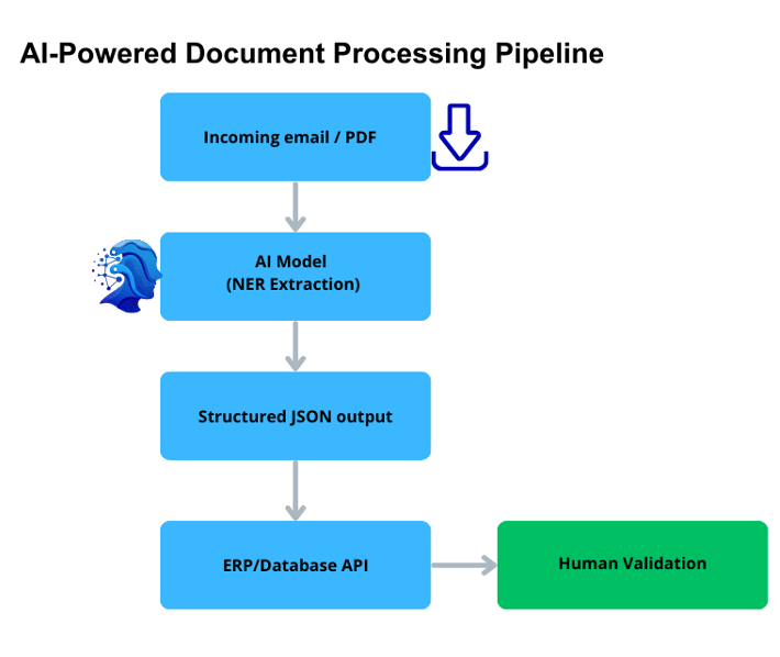

We often forget that the biggest bottleneck in legacy systems isn't the processing speed but the data entry. I’ve seen offices where experts spend 60% of their day reading PDFs or emails just to extract three numbers and type them into a legacy form. It’s a soul-crushing waste of human talent.
This is where GenAI can act as a Silent Auditor. I’ve moved away from the idea of "AI as a tool you talk to" and toward "AI as a utility you never see."
I recently worked on a pipeline where we used a small, specialized model to intercept incoming documents. The model doesn't "discuss" the document. It simply performs Named Entity Recognition (NER) and returns a clean, structured JSON object.
It sounds simple, but the shift in productivity is massive. We’re talking about moving from an approximately 1.5-minute manual task to a 2-second validation. When you scale that across thousands of documents, the ROI isn't just a number on a slide; but (trust me) it becomes a transformation of the workday.

If you’ve noticed a theme here, it’s that none of these solutions require a complete overhaul of your existing infrastructure.
In my work across different sectors, I’ve found that the most successful AI integrations are the ones that feel invisible. They don't try to be the star of the show. They are the quiet, efficient workers in the background making sure the data is clean, the queries are fast and the code is understood.
Is it perfect? No. AI still hallucinations and prompt injection is a real threat we have to architect against. But if we stop thinking about AI as a conversational partner and start seeing it as a cognitive API, we can finally unlock the value trapped in our legacy systems.
So, the next time someone asks you to add a chatbot to your app, take a step back. Look at your friction points. Look at your messy data. The real magic happens when the AI is so well integrated that the user doesn't even know it's there.
1. The Semantic Liaison: Natural Language for Legacy Databases
2. The Silent Auditor: Automating Unstructured Triage
- The Legacy Way: Human reads email, manually opens ERP, types name, date, amount.
- The Systems Thinking Way: AI reads email, extracts JSON, ERP API consumes JSON, Human gets a notification: "Validate this entry?"
