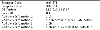

Three of our customers reporting same issue of Progress CRASH.
We have a procedure(.w file ) , running on a separate icon in the Server itself with -p param in the command line . This setup we used for Auto CAD interface. Customer is saying it crash after 3 days (Number of days may not be correct).
I am trying to replicate the issue in my local server , but I am not yet suceeded in that. It is working fine even after 5th day. It is not crashing.
I have attached the error screen shot they saw in the server console.
Progress Ver 10.2B
OS win2008 Server
Regards

What does the .w do? Is it clearing up handles and objects properly (could be a memory leak)?
I would add some client logging parameters to their session so the next time it bombs you could get a lot more details, like program and line number.
Might have Windows perfmon track their PID - would have to be setup manually after they started running the app. Would be able to see resources increasing though if there is a leak.
The trace files are telling you what line number blew up. So look at the source and see what it is doing at that point...

As you mention on your reply "The trace files are telling you what line number blew up. So look at the source and see what it is doing at that point..." .
I also had the same idea after I saw the Line# . What I did I compiled the .w with List option and reviewd. I could not found anything in that Line#.
I have attached that comilelog with this. Kindly have a look into it and give some clues what went wrong.
-Philip-
Hi,
In Line # 420 anything unusual. This Process Events can cause a Memory Leak?
-Philip-
