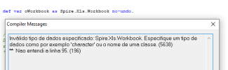

This don´t work.
def var oXlsWorkbook as Spire.Xls.Workbook.

When you say it does not work what error message are you getting?
If this is the message then it means your Progress session is not seeing/knows nothing of the relevant component:
Invalid datatype specified: Spire.Xls.Workbook. Specify a datatype such as 'character' or the name of a class. (5638)
** Could not understand line 1. (196)

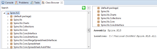

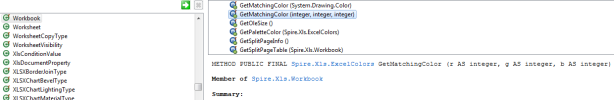

What you have done seems correct, and as per the first two attached images it should work okay.
Where are you getting the NotInheritable information from? As you can see from the last three attached images Progress Developer Studio does not say they are NotInheritable and only seems to have one version of the Workbook constructor.
I just cannot explain why you are having the problem.

That screen is the Class Browser screen in Progress Developer Studio:
Expand the relevant project - only available if you have created one - and Referenced Assemblies, right-click the component and select:
Yes, version 4.0 of the dll:

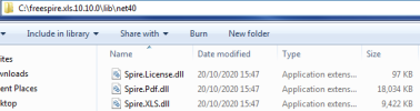

Unfortunately the three dll files are too large to attach but they were downloaded from here and all unblocked:
The assemblies.xml file is blocked from sending so have changed to text to show you how it looks.

With this, I have the error. I don't understand...
What is noticeable from your last image is Spire.Pdf.dll is missing, and so as a test I removed this from my directory and it then stopped working! So that seems to be the answer, links are being made with Spire.Pdf.dll.
I assumed Spire.Pdf.dll was for PDF work and not required for Excel workbooks but in this case is required.
