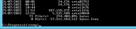

srt is large 287Mb - probably because it's filling up the temp-tables with the data from the input file and building the temp-table indexes but don't suspect it would be the sorting of database tables for want of indexes, or the right indexes
