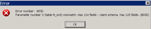

Hello to All members,
Can you please advise on how to resolve below error ?
This file tt_ord.i exists in two places in my E drive and and I have already verified that number of fields is same in both the files. But still I am getting this error.

The error 8030 in your screenshot is about a temp-table passed as a parameter, from somewhere to somewhere else. An ABL client to an App Server? Do you know? This error has nothing to do with the database(s).
Error 8030, from ProKB:
Parameter number (table <table name>) mismatch. Has <field#> fields - client schema has <fields#> fields. (8030)
Temp-table parameters match only if they have the same signature. An example of nonmatching temp-table parameters: The caller's temp-table signature is: {char, int, char}, and the called procedure temp-table signature is: {char, char, int}.
If the mismatch is between a non 4GL client (Java or ActiveX) and AppServer 4GL code, then the typical reason for the mismatch is a modified 4GL temp-table without client proxies rebuilt.
Those files may not even be a part of this application. This really doesn't tell us anything without knowing the compile propath(s).
Presumably, you are implying that each of these clients has its own compile with its own propath and each is using a different version of an include with the same name. (That would defeat the purpose of using an include file for a shared definition, but that's a separate conversation.) Also, you say that the same number of fields are in the temp-table definitions in both includes. But according to your screenshot, the compiler says that one temp-table definition has 114 fields and the other has 115 fields. I know which one I believe.
We can really only speculate without knowing more about these clients. Read the 8030 description above. Are they ABL GUI/CHUI clients? App Servers? Open Clients? Do you need to generate client proxies? Does each have its own code or do they share code? Right now you don't know which includes are being used on each side.

Sure, I will quickly focus on the Error 8030 for now and will try to find out the spot where the system encounters with the discrepancy in number of fields. It happens during the appserver connect call below, and I get that error 8030. Will get back real quick.
RUN fill.p ON SERVER pserv TRANSACTION DISTINCT
(INPUT Qtext,
INPUT iRecordLimit,
OUTPUT TABLE tt_ord,
OUTPUT fiNum,
OUTPUT lRecords) NO-ERROR .

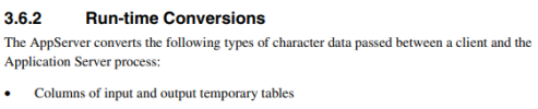

I found two concepts, which seem to be related to the error 8030, below snapshots. By looking at the error, the procedure is getting executed in an appserver instance and may be there the tt_ord has 114 fields.
To find the appserver propath, I checked ubroker.properties and got below path. But I could not find the respective .P at these locations.
{&G_APP_SERVER_CONNECT} cConnect values --> "2600 -H dsc-aix-dev - AppService twlappsrv -S 7182"
I will be researching more, but your inputs would really help here.
