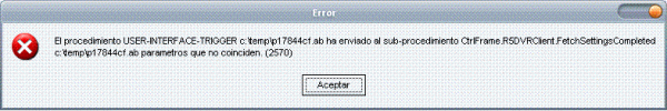

This works fine too. But when the component raise the "FetchSettingsCompleted" event, progress give me this error:
"The USER-INTERFACE-TRIGGER procedure c:\temp\p17844cf.ab has sent to sub-procedure CtrlFrame.R5DVRClient.FetchSettingsColmpeted c:\temp\17844cf.ab parameters do not match. (2570)"
Can anyone help me please. I'm working with Progress 9.1D and March Software SDK (accesing digital video), Windows XP SP2.
