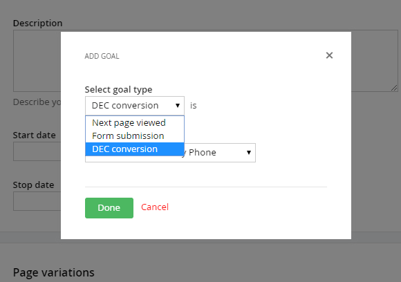

Goals
The last thing that you need to do is create a goal. Right from this same screen, you can select the goal you wish to measure your experiment with. You can choose from three options:
- Next page viewed—This can be any page from the website
- Form submission—This tracks any Sitefinity CMS form on the page variations (for example, the Contact Us form)
- DEC conversion—You can select from the list with conversion goals you defined in Digital Experience Cloud
What happens when there is a goal that you want to measure that isn’t in any of these lists? Just create it as a conversion in DEC and start tracking it.
You may also have more than one goal that you wish to track, but you can only have one primary goal.Only one will decide if this test was a success or not.
