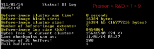

I'm a bit confused re BI
We have a directory which contains our BI files, 6 in total which seem to grow to 2G each.
Does each of these files represent one cluster?
Why in promon and proutil do I seem to have a disparity with BI size and BI cluster size (see attached)
Rob Fitzpatrick
The number and size of the extents (files) that make up the BI is determined by the database structure, which is specified with structure files and prostrct commands. The sum of all these extents makes up "the BI file" (aka "the before image area" aka "the primary recovery area").
BI blocks and clusters are unrelated to the number or dimension of the files. BI block size (in KB) is chosen with proutil dbname -C truncate bi -biblocksize n. BI cluster size (also in KB) is chosen with proutil dbname -C truncate bi -bi n. BI clusters are logical structures within the BI file.
The various screens where you see BI block size and cluster size are all telling you the same thing. Proutil describe is a little confusing as it gives you cluster size in units of 16 KB instead of KB, but if you do the math (1024 * 16 KB = 16 MB) it's the same size you see in promon screen 7 or R&D 1 9.
When you talk about the size of the BI file, there are two ways to look at it: the physical size (sum of the sizes of the extents) and the logical size (the number of active BI clusters * the BI cluster size). Promon 5 and R&D 1 9 both show you physical size, just in different units.
When you truncate the BI file (proutil dbname -C truncate bi) you are changing the file logically. And if the variable BI extent had grown, or was the only extent, the command also changes that file physically.
The command commits the changes it contains to the database extents so that the physical structure of the BI file can be reset back to what is dictated in the structure file. The next time you open the database after a truncate bi it allocates four BI clusters. If they fit within fixed-size extents then the files don't have to grow. If they don't, or if there is only a variable extent, the variable extent grows to a size large enough to fit four BI clusters. If you issue a proutil bigrow n command after truncate bi, it allocates n more clusters in addition to the original four.
In your case, if you have six extents of 2 GB each, they don't "grow". They are fixed-size; that's what the "f" in the structure file line items means. They stay at the allocated size (in KB) no matter what you do, including truncate bi. You can have at most one variable-size extent per storage area and it must be the last extent. If an extent isn't marked as "f" or "v" then it is variable.

Okay, thanks. I'm just trying to get my head around why we are having so many partial writes on BI. I see 12G worth of physical BI files five are "f" and one is "v", one place tells me the BI is 8166M, proutil says something a little different/but the same. Cluster size is set at 16384 and yet we continue to have many partial writes. I don't get it. -mf is set at 3, but after reading the details of -mf per progress, still not sure if this is the cause. And still have many BI buffer busy waits despite the fact that BI is now isolated on its own disk. I'm quite baffled at this point. Additionally, I'm not sure how many BI clusters we have, but if we are at a default of 4, why does it take 12G of physical files to service 4 clusters of 16384 each.
Rob Fitzpatrick
It doesn't. 4 clusters * 16 MB/cluster = 64 MB. When the database needs to add a new BI cluster (and whether it does is a function of your application and your user activity) that will be done within the fixed extents so no new file system allocation will need to be done. It will just be a matter of formatting the BI blocks within the new cluster. That is why some people choose to use fixed extents; so you don't take the run-time hit of allocating new clusters and extending the file. Whether that is a measurable benefit these days is another discussion.
I believe busy buffer waits will be a function of transaction volume which you can't do a lot about.
TheMadDBA
Active Member
BI buffer busy waits refer to the lack/conflict of the memory structures set by -bibufs. No relation to IO issues. You are going to have some on a busy system no matter what... in you are getting hundreds a second it could be something to worry about. A few a second is nothing.
