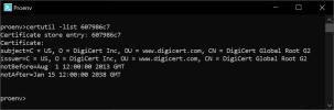

Additional information on what the OpenEdge command line tool produces.
Cecil
